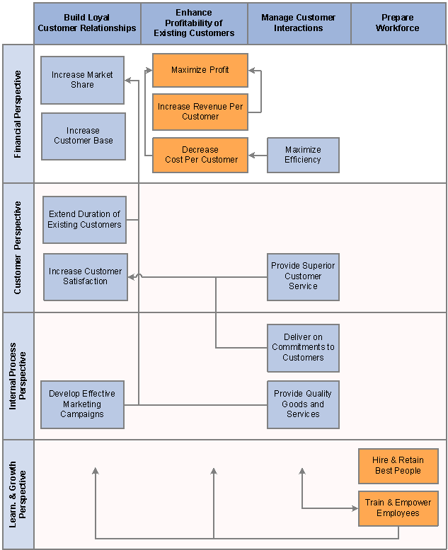

The following diagram is an example of critical success factors for a customer scorecard:
Critical success factors within a customer scorecard
Using the predefined KPIs as a baseline, the marketing, sales, and customer support staff, as well as company management, can view company performance for these critical success factors by perspective type. Easy and timely access to this information allows management to track progress toward company goals and to take immediate action when necessary.

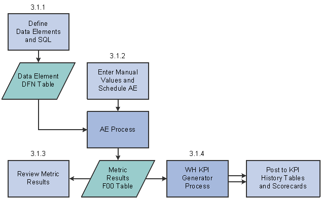

Batch ProcessesYou must run the following jobstreams to populate key tables:
KP_ANALYZE
This jobstream populates KP_KPI_CALC_F00 and KP_KPI_ASMT_F00. Run this jobstream to validate the KPI calculation rules, verify end values, and test the KPI assessment rules.
BC_ANALYZE
This jobstream populates KP_KPI_CALC_F00, KP_KPI_ASMT_F00, and BC_ASSESS_F00. Run this jobstream to generate the final scorecard assessments after you validate your setup (by running KP_ANALYZE). If you set up this job to run regularly, the KPI process can aggregate data month-to-month and year-to-date. You must run this process after you populate or update the Performance Management Warehouse tables (such as during the Extract, Transform, and Load process) to view current results for your customer scorecard.
