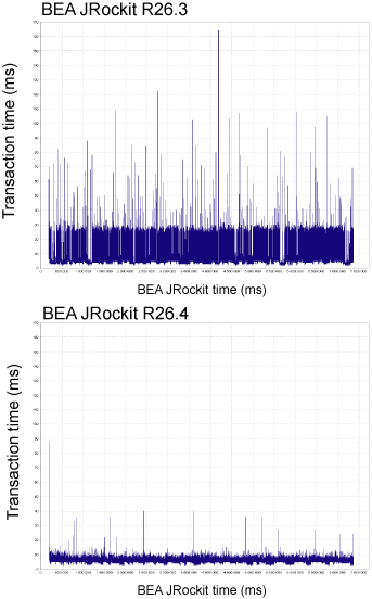

The performance of BEA JRockit has gone through major improvements for low latency applications by the following additions:
See Figure 3 for an illustration of how the performance have been improved with the above improvements.
