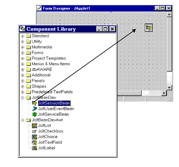

When you are ready to add JoltBeans to the Component Library of your development environment, add only the development version of JoltBeans. Refer to Using Development and Run-time JoltBeans for complete details.

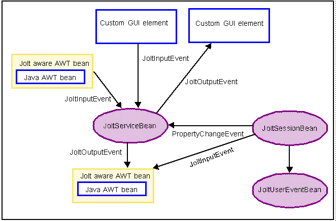

How JoltBeans Use JavaBeans Events
A Jolt client applet or application that is built using JoltBeans typically consists of Jolt-aware GUI beans, such as JoltTextField or JoltList, and JoltBeans, such as JoltServiceBean and JoltSessionBean. The main mode of communication between Beans is by JavaBeans events.
Jolt-aware beans are sources of JoltInputEvents or listeners of JoltOutputEvents or both. JoltServiceBeans are sources of JoltOutputEvents and listeners of JoltInputEvents.
The Jolt-aware GUI Beans expose properties and methods so you can link the beans directly to the parameters of an Oracle Tuxedo service (represented by a JoltServiceBean). Jolt-aware beans notify the JoltServiceBean via a JoltInputEvent when their content changes. The JoltServiceBean sends a JoltOutputEvent to all registered Jolt-aware beans when the reply data is available after the service call. The Jolt-aware GUI Beans contain logic that updates their contents with the corresponding output parameter of the service.
The following figure represents the possible relationships among the JoltBeans.
Figure 6-1 Possible Interrelationships Among JoltBeans

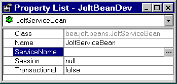

JoltServiceBean
The JoltServiceBean represents a remote Oracle Tuxedo service. The name of the service is set as a property of the JoltServiceBean. The JoltServiceBean listens to JoltInputEvents from other beans to populate its input buffer. JoltServiceBean offers the callService() method to invoke the service. JoltServiceBean is an event source for JoltOutputEvents that carry information about the output of the service. After a successful callService(), listener beans are notified via a JoltOutputEvent that carries the reply message.
Although the primary way of changing and querying the underlying message buffer of the JoltServiceBean is via events, the JoltServiceBean also provides methods to access the underlying message buffer directly (setInputValue(…), getOutputValue(…)).
The following table shows the JoltServiceBean properties and descriptions.
Table 6-2 JoltServiceBean Properties and Descriptions
Property
Description
ServiceName
The name of the Oracle Tuxedo service represented by this JoltServiceBean.
Session
The JoltSessionBean associated with the bean that allows access to the Oracle Tuxedo client session.
Transactional
Set to true if this JoltServiceBean is to be included in the transaction that was started by its JoltSessionBean.

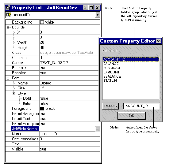

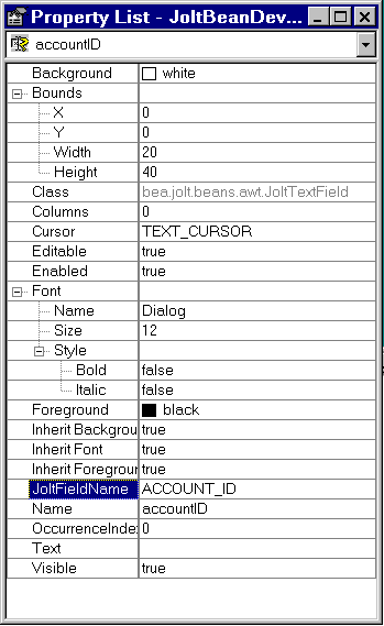

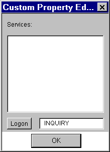

Using the Property List and the Property Editor to Modify the JoltBeans Properties
The values of most JoltBeans properties can be modified by editing the right column of the Property List in your integrated development environment (IDE), such as Visual Café, as shown in the following figure Property List: Ellipsis Button.

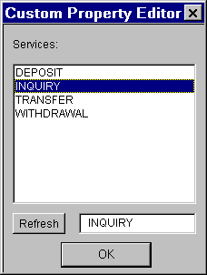

Custom property editors are provided for some properties of JoltBeans.
The custom property editors, accessed from the Property List, include dialog boxes that you use to modify the property values. You can invoke the custom property editors from the Property List by clicking the button with the ellipsis ( “...”) that is next to the value of the corresponding property value.
Figure 6-2 Property List: Ellipsis Button
When you click the ellipsis button, the Property Editor shown in the following figure is displayed.
Figure 6-3 Custom Property Editor Dialog Box
The Custom Property Editor of JoltBeans reads cached information. Initially, no cached information is available, so when the Property Editor is used for the first time, the dialog box is empty. Log on to the Jolt Repository and load the property editor cache from the repository.
For details about the logon and using the Property List and Property Editor, see Using the Jolt Repository and Setting the Property Values.

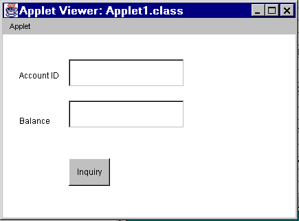

This walkthrough describes how to build an applet that you use to:

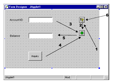

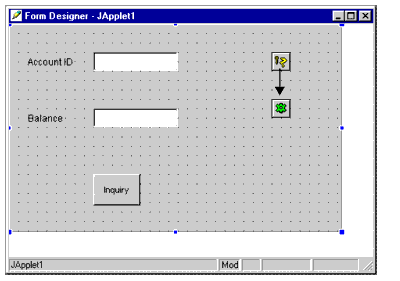

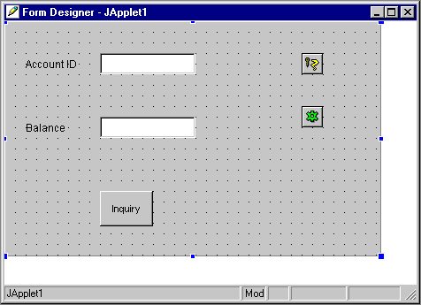

The following figure shows an example of a completed Java form containing JoltBeans. The applet implements the client functionality for the INQUIRY service of the BANKAPP sample that is included with Oracle Tuxedo. To run this sample, the Oracle Tuxedo server must be running.
Figure 6-4 Sample Inquiry Applet

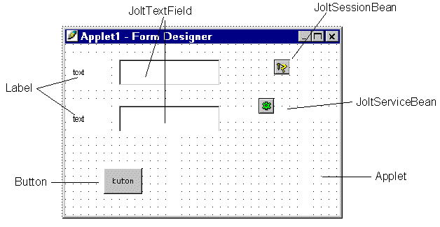

Refer to the figure Visual Café 3.0 Form Designer for an example of each item required by the Java form. Each item in that figure is described in the following table Required Form Elements.
Table 6-4 Required Form Elements
Element
Purpose
Applet (or JApplet, if JFC applet is chosen)
A form used to paint the beans in your development environment.
JoltSessionBean
Logs on to an Oracle Tuxedo session.
JoltTextField
Gets input from the user (in this case, ACCOUNT_ID).
JoltTextField
Displays the result (in this case, SBALANCE).
JoltServiceBean
Accesses an Oracle Tuxedo service. (In this case, INQUIRY from BANKAPP).
Button
Initiates an action.
Label
Describes the field on the applet.

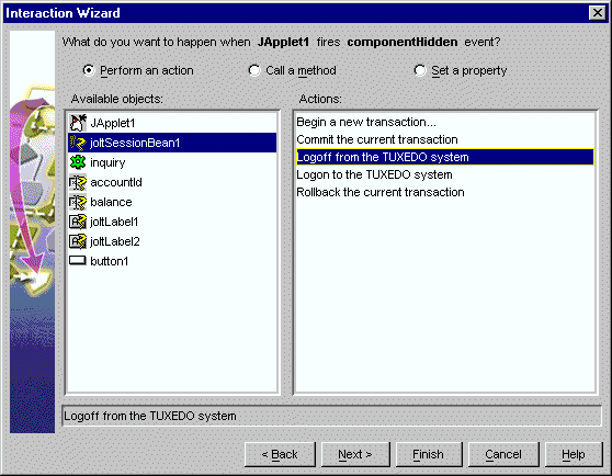

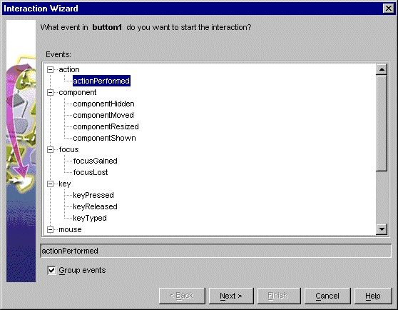

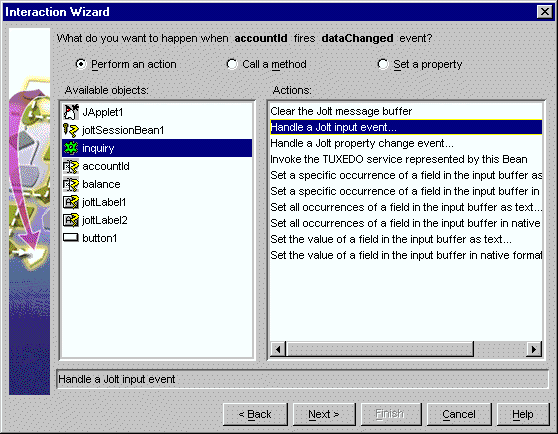

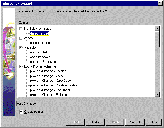

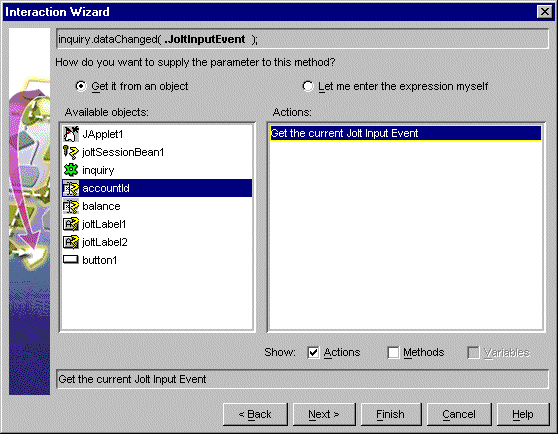

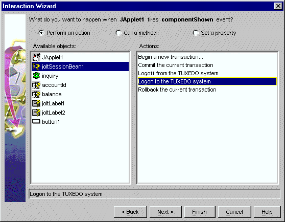

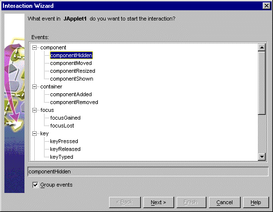

  1. In Visual Café, choose FileArrow symbolNew Project and select either JFC Applet or AWT application. This step provides you with the basic form designer on which you drop the JoltBeans.
  2. Drag and drop all of the JoltBeans you want to use in your applet from the Component Library onto the form designer.

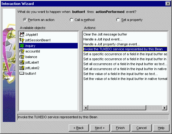

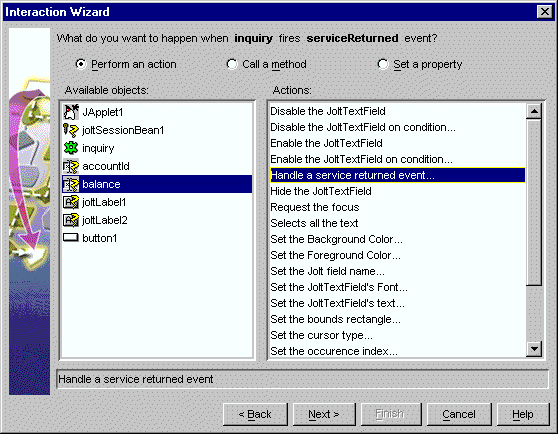

  3. Modify or customize each bean using the property list or the custom property editor.

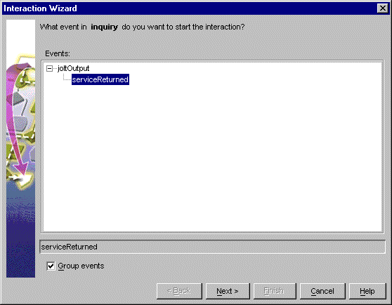

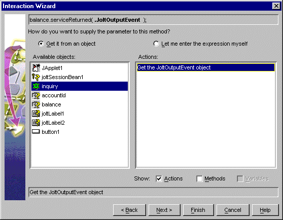

  4. Wire the beans together using the Interaction Wizard.
  5. Compile the applet.
These steps are described in detail in the following sections.

Placing JoltBeans onto the Form Designer
  1. Choose FileArrow symbolNew Project, and choose JFC Applet.
  2. Drag and drop the beans from the Component Library (shown in the following figure) onto the palette of the form designer.
  3. Figure 6-5 JoltBeans and the Form Designer in Visual Café
The following figure Visual Café 3.0 Form Designer illustrates how JoltBeans appear when they are placed on the palette of the Form Designer.
Figure 6-6 Visual Café 3.0 Form Designer
Visual Café 3.0<span style= Form Designer" id="wp341676"/>
  1. Set the properties of each bean. To modify or customize the buttons, labels or fields, use the property list. Some JoltBeans use a Custom Property Editor.
  2. The following figure,Example of JoltTextField Property List and Custom Property Editor, shows how selecting the JoltFieldName of the button property list displays the Custom Property Editor.
  3. Set the properties of the beans (for example, set the JoltFieldName property of the JoltTextField to ACCOUNT_ID).
Note: For complete information on setting and modifying the properties of the JoltBeans, refer to Using the Jolt Repository and Setting the Property Values.

Refer to the following figure Example of JoltTextField Property List and Custom Property Editorand Using the Jolt Repository and Setting the Property Values for general guidelines about JoltBean properties.
Figure 6-7 Example of JoltTextField Property List and Custom Property Editor
  1. To change the value of the JoltFieldName property, click on the ellipsis button of the JoltFieldName in the Property List.
  2. The Custom Property Editor is displayed.
  3. Select or type the new field name (in this example, “ACCOUNT_ID”) and click OK.
  4. The change is reflected in the Property List shown in the following figure Revised JoltFieldName in the JoltTextField Property Listand on the text field shown on the figure Example of JoltBeans on the Form Designer with Property Changes.
Note: The properties that are visible in the Custom Property Editor are cached locally; therefore, if the source database is modified you must use the Refresh button to see the current, available properties.
Figure 6-8 Revised JoltFieldName in the JoltTextField Property List
The following figure Example of JoltBeans on the Form Designer with Property Changes illustrates how the text on the button and the textfield changes after the text is added to the property list fields for these beans.
Figure 6-9 Example of JoltBeans on the Form Designer with Property Changes
  1. After you set the properties to the right values (refer to the table Required and Recommended Property Values for additional information), define how the beans will interact by wiring them together using the Visual Café Interaction Wizard. Refer to Wiring the JoltBeans Together for details.
After all the beans are positioned on your form and the properties are set, you must wire the beans and their events together. The following figure Sequence in Which JoltBeans Are Wired illustrates an example of the flow to help you determine the correct order in which to wire the beans.
Wiring the beans allows you to establish event source-listener relationships between various beans on the form. For example, the JoltServiceBean is a listener of ActionEvents from the button and invokes callService() when the event is received. Use the Visual Café Interaction Wizard to wire the beans together.
The following figure shows the sequence in which you will wire the beans together to create this sample applet. The numbers in this figure correspond to the numbered steps that follow.
Figure 6-10 Sequence in Which JoltBeans Are Wired
The steps below correspond to the callouts shown in the figure Sequence in Which JoltBeans Are Wired. Each of the steps below is detailed in the sections that follow.
Step 1: Wire the JoltSessionBean Logon
Step 2: Wire JoltSessionBean to JoltServiceBean Using PropertyChange
Step 3: Wire the accountID JoltTextField as Input to the JoltServiceBean Using JoltInputEvent
Step 4: Wire Button to JoltServiceBean Using JoltAction
Step 5: Wire JoltServiceBean to the Balance JoltTextField Using JoltOutputEvent
Step 6: Wire the JoltSessionBean Logoff
Step 7: Compile the Applet (not shown as a callout)

  7. The Interaction Wizard window is displayed, as shown in the figure Select Logon to the Tuxedo System Action, with the prompt:
    What do you want to happen when Japplet1 fires componentShown event?
  8. With the Perform an action radio button enabled, select the action Logon to the TUXEDO system, as shown in the following figure.
  9. Figure 6-13 Select Logon to the Tuxedo System Action
  10. Click Finish.
Completing Step 1: Wire the JoltSessionBean Logon enables the logon() method of the JoltSessionBean to be triggered by an applet (for example, ComponentShown) that is sent when the applet is opened for the first time.
  1. Click the Interaction Wizard icon in the Visual Café Form Designer window.
  2. Select the accountID JoltTextField bean and drag a line to the JoltServiceBean.
  3. The Interaction Wizard window is displayed, as shown in the following figure, with the prompt:
    What event in accountId do you want to start the interaction?
  4. Select dataChanged as the event, as shown in the following figure.
  5. Figure 6-18 Select dataChanged Event
  6. Click Next.
  7. The Interaction Wizard window is displayed as shown in the figure Select inquiry Object and Handle a Jolt input event Action, with the prompt:
    What do you want to happen when accountId fires dataChanged event?
  8. Select the joltServiceBean inquiry as the object supplying the parameter, as shown in the following figure.
  9. Select Handle a jolt input event as the action, also as shown in the following figure.
  10. Figure 6-19 Select inquiry Object and Handle a Jolt input event Action
  11. Click Next.
  12. The Interaction Wizard window is displayed as shown in Select accountId Object and Get the current Jolt Input Event Action, with the prompt:
    How do you want to supply the parameter to this method?
    and a list of available objects and actions from which to choose.
  13. Select accountId as the object, as shown in the following figure.
  14. Select get the current Jolt Input Event as the action, also as shown in the following figure.
  15. Figure 6-20 Select accountId Object and Get the current Jolt Input Event Action
  16. Click Finish.
Completing Step 3: Wire the accountID JoltTextField as Input to the JoltServiceBean Using JoltInputEvent enables you to type the account number in the first text field. The JoltFieldName property of this JoltTextField is set to “ACCOUNT_ID”. Whenever the text inside this text box changes, it sends a JoltInputEvent to the JoltServiceBean. (The JoltServiceBean listens to JoltInputEvents from this text box.) The JoltInputEvent object contains the name, value, and occurrence index of the field.
  2. Click the Inquiry Button and drag a line to the JoltServiceBean.
  3. The Interaction Wizard window is displayed as shown in the following figure, with the prompt:
    What event in button1 do you want to start the interaction?
  4. Select actionPerformed as the event, as shown in the following figure.
  5. Figure 6-21 Select action Performed Event
  6. Click Next.
  7. The Interaction Wizard window is displayed, as shown in the figure Select inquiry Object and Invoke the TUXEDO Service... Action, with the prompt:
    What do you want to happen when button1 fires actionPerformed event?
  8. Select inquiry as the object, as shown in the following figure.
  9. Select Invoke the TUXEDO Service represented by this Bean as the action, also as shown in the following figure.
  10. Figure 6-22 Select inquiry Object and Invoke the TUXEDO Service... Action
  11. Click Finish.
Completing Step 4: Wire Button to JoltServiceBean Using JoltAction enables the callService() method of the JoltServiceBean to be triggered by an ActionEvent from the Inquiry button.
  2. Select the JoltServiceBean and drag a line to the AmountJoltTextField bean.
  3. The Interaction Wizard is displayed, as shown in the following figure, with the prompt:
    What event in inquiry do you want to start the interaction?
  4. Select serviceReturned as the event, as shown in the following figure.
  5. Figure 6-23 Select ServiceReturned Event

  7. The Interaction Wizard window is displayed, as shown in the figure Select balance Object and Handle a service returned event Action, with the prompt:
    What do you want to happen when inquiry fires serviceReturned event?
  8. Select balance as the object, as shown in the following figure.
  9. Select Handle a service returned event... as the action, also as shown in the following figure.
  10. Figure 6-24 Select balance Object and Handle a service returned event Action
  11. Click Next.
  12. The Interaction Wizard window is displayed, as shown in the figure Select inquiry Object and Get the JoltOutputEvent object Action, with the prompt:
  13. Select inquiry as the object, as shown in the following figure.
  14. Select Get the JoltOutputEvent object as the action, also as shown in the following figure.
  15. Figure 6-25 Select inquiry Object and Get the JoltOutputEvent object Action
  16. Click Finish.

    What event in JApplet1 do you want to start the interaction?
  4. Select componentHidden as the event, as shown in the following figure.
  5. Figure 6-26 Select componentHidden Event

  7. The Interaction Wizard window is displayed, as shown in the figure Select joltSessionBean1 Object and Logoff from the Tuxedo System Action, with the prompt:
    What do you want to happen when JApplet1 fires componentHidden event?
  8. Select joltSessionBean1 as the object, as shown in the following figure.
  9. Select Logoff from the TUXEDO system as the action, also as shown in the following figure.
  10. Figure 6-27 Select joltSessionBean1 Object and Logoff from the Tuxedo System Action
  11. Click Finish.
Completing Step 6: Wire the JoltSessionBean Logoff enables the logoff() method of the JoltSessionBean to be triggered by an applet (for example, componentHidden) that is sent when the applet gets hidden.

Running the Sample Application
To run the sample application, you must have the Oracle Tuxedo server running. Then enter an account number in the Account ID textfield. You can use any of the account numbers included in the BANKAPP database. Following are two examples of account numbers you can use to test the sample application:

The property editor reads cached information from the repository and returns names of the available services and data elements in a list box. An example of the ServiceName property editor is shown in the following figure JoltServiceBean Property Editor.
To add or modify a property bean, follow these steps:
  1. Select the service name by clicking on the ellipsis in the ServiceName field shown in the following figure.
  2. Figure 6-28 JoltServiceBean Property Editor
    The Custom Property Editor for ServiceName shown in the following figure is displayed.
    Figure 6-29 Custom Property Editor for ServiceName
Note: If you cannot or do not want to connect to the Repository database, type the service name in the text box and skip to Step 7.
  1. If you are not logged on, make sure the Jolt Server is running and select Logon.
  2. The JoltBeans Repository Logon shown in the following figure is displayed.
    Figure 6-30 JoltBeans Repository Logon
  3. Type the Oracle Tuxedo or Jolt Relay Machine name in the Server field and the JSL or Jolt Relay in the Port number field.
  4. Type the password and username information (if required) and click Logon.
  5. The Custom Property Editor loads its cache from the repository and is displayed, as shown in the following figure Property Editor with Selected Service.
  6. Select the appropriate service name from the list box, as shown in the following figure.
  7. Enter the property value (service or field name) directly.
  8. A text box is provided.
  9. Click OK in the Custom Property Editor dialog.
  10. The bean property is set with the contents of the text box.
    Figure 6-31 Property Editor with Selected Service
  11. Click OK in the Custom Property Editor dialog box again.

Using Custom GUI Elements with the JoltService Bean
JoltBeans provides a limited set of Jolt-enabled GUI components. You can also use controls that are not Jolt-enabled together with the JoltServiceBean. You can link controls to the JoltServiceBean that display output information of the service represented by the JoltServiceBean. You can also link controls that display input information.
For example, a GUI element that uses an adapter class to implement the JoltOutputListener interface can listen to JoltOutputEvents. The JoltServiceBean as the event source for JoltOutputEvents calls the serviceReturned() method of the adapter class when it sends a JoltOutputEvent. Inside serviceReturned(), the control’s internal data is updated using information from the event object.
The development tool generates the adapter class when the JoltServiceBean and the GUI element are wired together.
As another example, a GUI element can call the setInputTextValue() method on the JoltServiceBean. The GUI element contains input data for the Oracle Tuxedo service represented by the JoltServiceBean.
As a third example, a GUI element can implement the required methods (addJoltInputListener() and removeJoltInputListener()) to act as event sources for JoltInputEvents. The JoltServiceBean acts as an event listener for these events. The control sends a JoltInputEvent when its own state changes to keep the JoltServiceBean updated with the input information.
