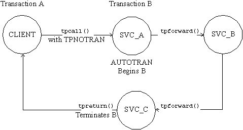

If you issue a communication call with TPNOTRAN
set and the called service is configured such that a transaction automatically starts when the service is called, the system places both the calling and called processes in transaction mode, but the two constitute different transactions. In this situation, the following facts apply:
TPRETURN
plays the initiator’s transaction role: it terminates the transaction in the service in which the transaction was automatically started. Alternatively, if the transaction is automatically started in a service that terminates with TPFORWAR
, the TPRETURN
call issued in the last service in the forward chain plays the initiator’s transaction role: it terminates the transaction. (For an example, refer to the figure called Transaction Roles of TPFORWAR and TPRETURN with AUTOTRAN.)TPRETURN
is vulnerable to the failure of any participant in the transaction, as well as to transaction timeouts. In this scenario, the system is more likely to return a failed message.
