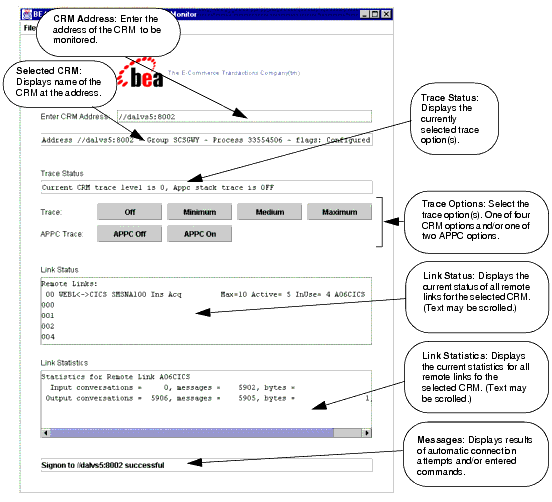

The CRM Monitor is a Java application that allows you to connect to and monitor the CRM server through a graphical user interface (GUI). You can use the CRM Monitor to monitor link status and activity and start or stop diagnostic tracing of the CRM server. The CRM Monitor makes a network connection to the remote CRM server through a TCP/IP network connection. The CRM Monitor is installed with the Gateway, not on the mainframe.
If the CRM Monitor is installed on Windows, a short cut is created in the Start menu of the Desktop when you install Oracle Tuxedo Mainframe Adapter for SNA.
To launch the CRM Monitor from the Desktop:
The CRM Monitor can also be started from the command line on UNIX
To launch the CRM Monitor from the command line:
Figure 3-1 shows an example of the CRM Monitor display.
After you launch the CRM Monitor, use the following instructions to set CRM Monitor options:
//host:port
where host explicitly specifies the CRM host machine and port specifies the port number of the CRM on the CRM host machine.
This value may only be entered once per started instance of a CRM Monitor.
0 as described in the Trace Options section for the
CRM command.1 as described in the Trace Options section for the
CRM command.2 as described in the Trace Options section for the
CRM command.3 as described in the Trace Options section for the
CRM command.| Note: | The CRM Monitor does not show trace data. This data is captured in a file under the APPDIR directory of the CRM server (APPDIR is the variable name associated with the CRM directory). Please contact Oracle Customer Support for help in locating the trace file(s) and interpreting them. |
