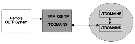

Using TMA OSI TP as a Pass-Through to Other Tuxedo Systems
For this example, the TMA OSI TP gateway acts as a pass-through to allow access to services on other Tuxedo systems. The TMA OSI TP gateway receives service requests from a remote OLTP system and then forwards them through the /TDOMAINS gateway to a remote Tuxedo system. The systems are as follows:
Figure 4-1 Example of TMA OSI TP Acting as a Pass-Through to Other Tuxedo Systems
Listing 4-7 shows a sample UBBCONFIG file and Listing 4-8 shows the corresponding DMCONFIG file for a pass-through configuration.

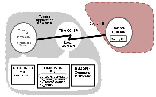

Setting up Security
Oracle TMA OSI TP supports the following two types of security:
The Oracle Tuxedo UBBCONFIG and TMA OSI TP DMCONFIG files include five sections in which you specify security parameters for whichever type of security you want to implement:
The following figure shows the relationships between security elements for TMA OSI TP.
Figure 4-2 TMA OSI TP Security Elements
