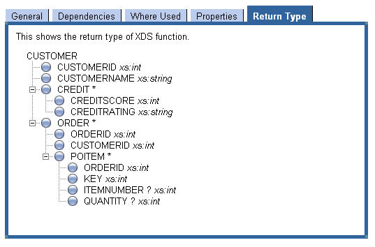

An interface is also generated for each complex property (such as CREDIT and ORDER shown in Figure 2-3), with getters and setters for each of the properties that comprise the complex type.
For many-valued properties, a get method is generated that returns a java.util.List object. A many-valued property corresponds to an XML schema element that has maxOccurs greater than one. The List returned by a get method for a many-valued property is “live.” This means that if you modify the List object, the changes are reflected directly and immediately in the containing data object.
As an example of how static data object APIs are generated, given the CUSTOMER data type shown in Figure 2-3, generating typed client interfaces results in CUSTOMER, CREDIT, ORDER, and POITEM interfaces, each of which includes getters, setters, and factory classes (for instantiating static data objects and their properties).

Oracle Data Service Integrator client application developers can use the Oracle Data Service Integrator Administration Console to view the XML schema types associated with data services (see Figure 2-3, CUSTOMER Return Type Displayed in Oracle Data Service Integrator Administration Console’s Metadata Browser, on page 2-5). The Return Type tab indicates the data type of each element—string, int, or complex type, for example. The XML schema data types are mapped to corresponding Java types using the data type mappings shown in Table 2-5.
