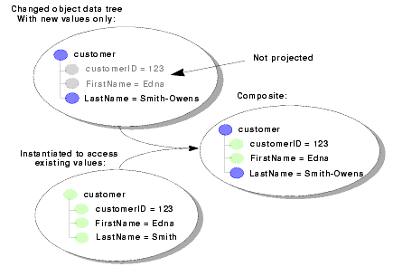

For data objects bound to logical data services, the mediator must first identify where the changed information came from. It does so by analyzing (essentially inverting) the function designated as the decomposition function of the data service bound to the data object. The decomposition function enables the mediator to determine the lineage of data, that is, the physical source for each individual element in the data object. This lineage information is expressed in the form of a decomposition map.
Note: If a function for decomposition is not explicitly specified in a data service, the mediator uses the first read function in the data service as the decomposition function. In most cases any of the read functions will do.

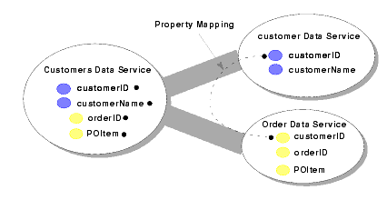

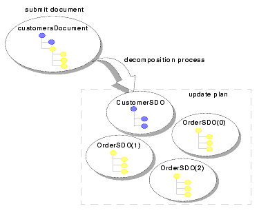

If data comes from more than one source, the incoming SDO object is decomposed into its constituent parts. The physical level data objects corresponding to the changed values in the updated data object are instantiated.
For example, a customersDocument object that is made up of an updated customer information from a Customer data service and three updated Order objects from an Orders data service would be decomposed into four objects, as illustrated in Figure 3-1.
By analyzing the change summary and decomposition map the mediator automatically derives an update plan. The update plan indicates what physical resources will be modified and how. (See Accessing the Decomposition Map on page 3-20 for a description of decomposition maps.) The update plan only has access to the modified objects in a submitted data graph. Unchanged objects do not appear in the plan, and data services for unchanged objects will not be accessed during the update.

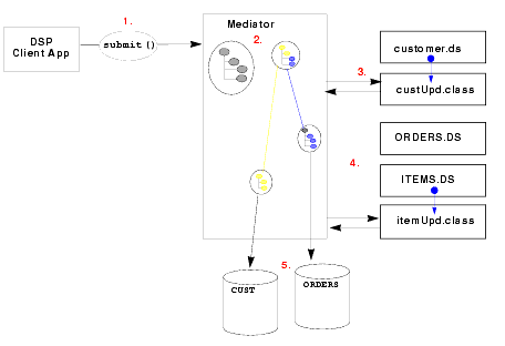

There are a number of steps performed in the updating of a data source. The following are the steps in the update process:
Figure 3-2 illustrates the steps in the update processing sequence used to update a data source. In this example, the mediator performs the final step of the update, known as data change propagation.
Figure 3-2 Update Processing Sequence
An update override is a Java class associated with a data service. An update override lets you hook custom code into the default update process and is useful for customizing the default behavior, validating data, propagating data changes to a non-relational source, or applying any other processing action desired.
An update plan is generated for any change submitted for a data object bound to a logical data service. However, automatic update propagation will occur only if the data source is relational. If it is not, an update override class must be implemented to propagate changes to the physical data sources. (However, you will get an exception if no update override is available for an updated physical data service that is non-relational.) The override class must implement the UpdateOverride interface and contain a performChange method, which indicates to the mediator whether or not it should resume the normal course of processing after the update to apply any further changes. (For more information about the update override class, see Developing an Update Override Class on page 3-10.)
For logical data services (such as Customers) the update override class is called before the update plan is generated. For physical services, it is called immediately before update propagation. If decomposition yields multiple instances of a changed data object (for example, multiple Orders for a customer), an update override for the Order data service would be called multiple times, once for each changed object.

Note that any information not projected in the top-level data service will not be able to be resupplied to the intermediate data service.
For example, say that a top-level data service provides a list of orders. It gets the information by calling a function in another logical data service that returns all customer information with their orders. When the orders-only function is called, the view is flattened so that only order information is retrieved from the data source.

After possibly validating or modifying the values in the submitted data object, the function retrieves the update plan by passing in the current data object to the following function:
DataServiceMediatorContext.getCurrentUpdatePlan()
The update plan can be augmented in several ways, including:
DataServiceMediatorContext.executeUpdatePlan()
After executing the update plan, the function should return false so that the mediator does not attempt to apply the update plan.
The update plan lets you modify the values to be updated to the source. It also lets you modify the update order.
You can walk the update plan to view its contents. To walk the plan, you can use a call similar to the method navigateUpdatePlan() shown in Listing 3-3 where the method is called from a performChange method (see UpdateOverride Interface on page 3-10 for information about this method) and recursively walks the plan.
Listing 3-3 Walking an Update Plan
public boolean performChange(DataGraph datagraph){
UpdatePlan up = DataServiceMediatorContext.currentContext().
getCurrentUpdatePlan( datagraph );
navigateUpdatePlan( up.getDataServiceList() );
return true;
private void navigateUpdatePlan( Collection dsCollection ) {
DataServiceToUpdate ds2u = null;
for (Iterator it=dsCollection.iterator();it.hasNext();) {
ds2u = (DataServiceToUpdate)it.next();
// print the content of the SDO
System.out.println (ds2u.getDataGraph() );
// walk through contained SDO objects
navigateUpdatePlan (ds2u.getContainedDSToUpdateList() );
A sample update plan report would look like the following
UpdatePlan
SDOToUpdate
DSName: ... :PO_CUSTOMERS
DataGraph: ns3:PO_CUSTOMERS to be added
CUSOTMERID = 01
ORDERID = unset
PropertyMap = null
Now consider an example in which a line item is deleted along with the order that contains it. Given the original data, the following listing illustrates an update plan in which item 1001 will be deleted from Order 100, and then the Order is deleted.
UpdatePlan
SDOToUpdate
DSName:...:PO_CUSTOMERS
DataGraph: ns3:PO_CUSTOMERS to be deleted
CUSTOMERID = 01
ORDERID = 100
PropertyMap = null
SDOToUpdate
DSName:...:PO_ITEMS
DataGraph: ns4:PO_ITEMS to be deleted
ORDERID = 100
ITEMNUMBER = 1001
PropertyMap = null
In this case, the execution of the update plan is as follows: before deleting the PO_CUSTOMERS, its contained SDOToUpdates are visited and processed. So the PO_ITEMS is deleted first and then the PO_CUSTOMERS.
If the contents of the Update Plan are changed then the new update plan can be executed and the update exit should then return false, signaling that no further automation should occur.
The plan can then be propagated to the data source, as described in Executing an Update Plan.
After modifying an update plan, you can execute it. Executing the update plan causes the data service mediator to propagate the changes in the update plan to the indicated data sources.
Given a modified update plan named up, the following statement executes it:
context.executeUpdatePlan(up);
