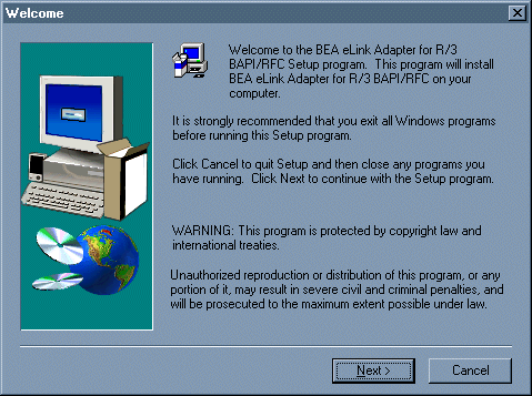

Figure 4-1 Welcome to BEA eLink Adapter for R3 Setup Program

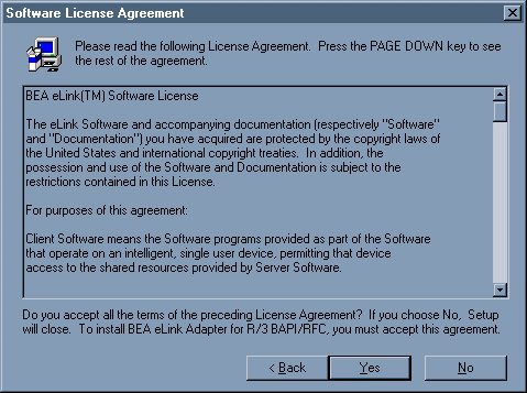

Figure 4-2 License Agreement

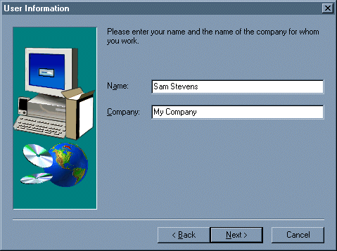

Figure 4-3 Provide User Information

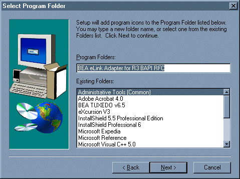

Figure 4-6 Select a Program Folder

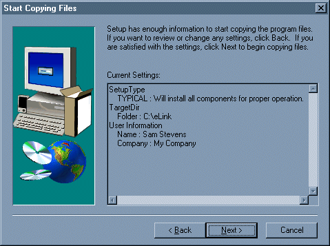

Figure 4-7 Current Settings

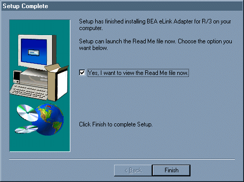

Figure 4-8 Setup Complete
