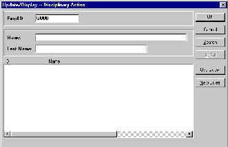

The PeopleSoft dialog box used in this integration example is the "Disciplinary Action" panel. This panel is created as part of PeopleSoft's demonstration application, PTDMO.
Perform the following steps to display the Disciplinary Action dialog box.

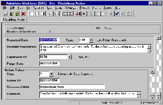

For the purposes of this example, the Disciplinary Action dialog box is the object from which PeopleSoft internal information will be gathered.
Using the Message Definition Attributes worksheet in the back of this chapter, record the following information in the GUI name column.
Figure 7-3 Disciplinary Action Dialog Box

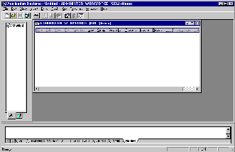

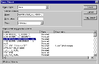

Perform the following steps to obtain the internal menu name.
Figure 7-4 Open Object Dialog Box
Figure 7-5 Application Designer Dialog Box

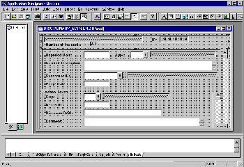

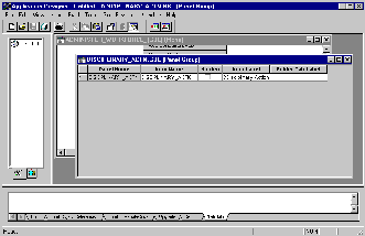

To obtain the panel name and panel group, you must open and examine the panel within the PeopleTools Application Designer.
Perform the following steps to obtain the internal panel name and group.
Figure 7-6
Perform the following steps to obtain the Search Record.
Figure 7-7 Panel Group Properties Dialog Box
Perform the following steps to obtain Record and Field names.
Figure 7-8 DISCIPLINARY_ACTN.ENG Panel
Figure 7-9 Panel Field Properties Dialog Box

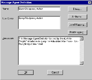

Once you have obtained the Message Definition attributes and the field names associated with the GUI controls, you can create a Message Definition to access the panel's information from a TUXEDO application.

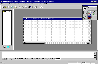

Perform the following steps to create the activity and message definition.
Figure 7-10 Business Process Panel
Figure 7-11 Activity Choices Window
Figure 7-12 Activity Definition Dialog Box
Figure 7-13 Message Agent Definition Dialog Box

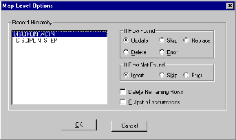

Figure 7-15 Map Level Options Dialog Box

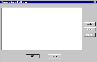

Figure 7-16 Message Agent Field Map Dialog Box

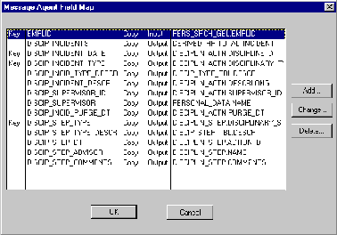

Using the information recorded in the Message Definition Fields worksheet at the back of this chapter, map each field in the Message Agent Field Map so that this information can be retrieved by TUXEDO applications.

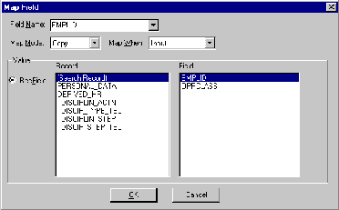

Figure 7-17 Map Field Dialog Box

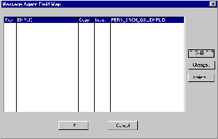

Figure 7-18 Message Agent Field Map
Notice that the Field Name defined in the Message Agent map does not have to match the field name of the record.
Figure 7-19 Complete Message Agent Map Definition
