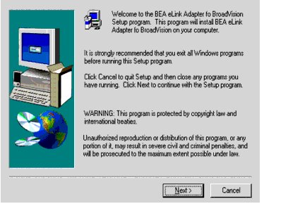

Figure 2-1 Welcome

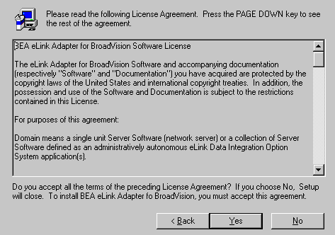

Figure 2-2 License Agreement

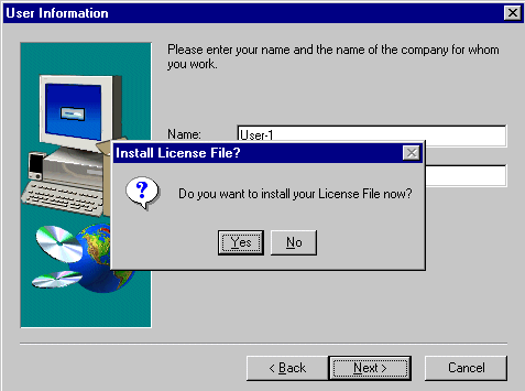

Figure 2-3 User Information
Figure 2-4 Install License Key Pop-Up Window
Note: For additional license key information, refer to the eLink Adapter for BroadVision Release Notes.

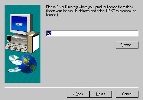

Figure 2-5 License File Browser Window
Click Yes in the Install License File pop-up window as shown in Figure 2-4 to
install the license file. Click Browse to locate the License file as shown in
Figure 2-5. Click Next to continue with the installation process.

Click No in the Install License File pop-up window as shown in Figure 2-4 to
bypass the installation of the license file now. Be sure to install the license file
prior to initializing the software.
A progress bar displays the status of the installation. You may abort the installation process any time prior to completion by clicking the Cancel button.
Note: If you select No, the installation continues but an error is generated in the ulog.mm/dd/yy file indicating that the product is unlicensed. Please refer to the "Using the License Key" section of the BEA eLink Adapter for BroadVision Release Notes for instructions on using the license file.
