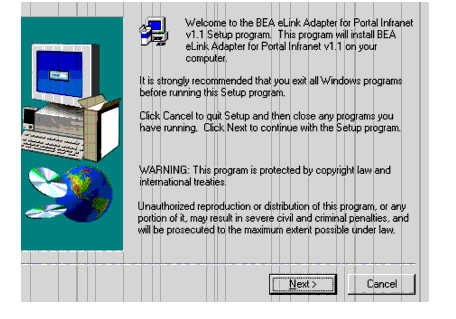

Perform the following steps to install the eLink Adapter for Portal Infranet software on a Windows NT system:
Figure 2-1 Welcome

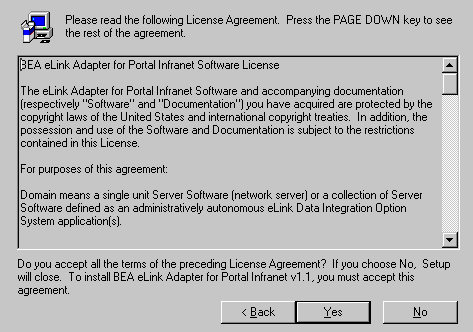

Figure 2-2 License Agreement

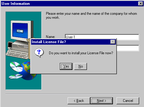

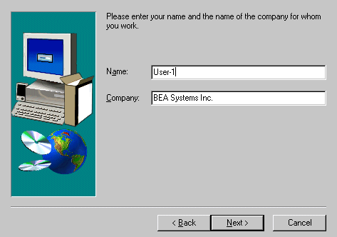

Figure 2-3 User Information
Note: For additional license key information, refer to the eLink Adapter for Portal Infranet Release Notes.
Figure 2-4 Install License Key Pop-Up Window

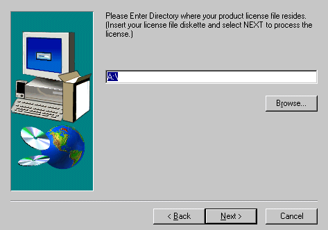

Figure 2-5 License File Browser Window
Click Yes in the Install License File pop-up window as shown in Figure 2-4 to
install the license file. Click Browse to locate the License file as shown in
Figure 2-5. Click Next to continue with the installation process.
A progress bar displays the status of the installation. You may abort the installation process anytime prior to completion by clicking the Cancel button.
Click No in the Install License File pop-up window as shown in Figure 2-4 to
bypass the installation of the license file now. Be sure to install the license file
prior to initializing the software.
Note: If you select No, the installation continues but an error is generated in the ulog.mm/dd/yy file indicating that the product is unlicensed. Please refer to the "Using the License Key" section of the BEA eLink Adapter for Portal Infranet Release Notes for instructions on using the license file.

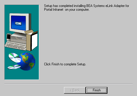

When the installation completes, the Setup Complete window shown in Figure 2-7 notifies you that the eLink Adapter software is installed on your system.

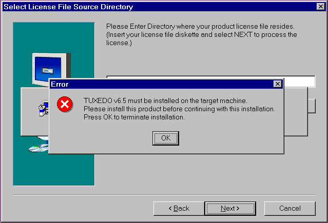

If eLink Platform is NOT already installed on your system:
If BEA eLink Platform is not installed on your system, the following Error pop-up window displays as shown in Figure 2-6. Click OK on the pop-up window to terminate the installation process. Install eLink Platform on your system (see warning above). Re-initiate the installation process starting with step one of these installation instructions.
Figure 2-6 eLink Platform Installation Error Pop-Up Window
Figure 2-7 Setup Complete
