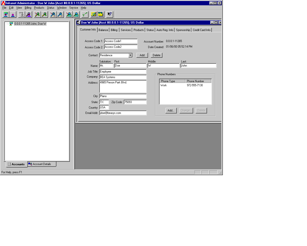

Step 7: Create a Customer Account
Included with the eLink Adapter for Portal Infranet is a sample eLink Platform client program. This supplied client create_cust.c creates a customer named John W. Doe within the Portal Infranet system. This client takes the service name as a parameter and creates the customer John W. Doe from hard-coded test data. The client creates an FML32 request buffer containing the hierarchical data for the new customer John W. Doe. This buffer is then sent to the Portal Infranet adapter service, and the response is returned. The FML32 response buffer is printed to standard out using the FML function Fprint32().
Step 7.1 Examine the Sample Client Program
Before you build the sample client program, examine the program for several important considerations. Table 5-2 provides a key to some important information for you to consider as you examine the sample client program. Listing 5-10 shows the source code for the sample client program. Use the following steps to access the source code:
Table 5-2 Sample Client Program Information Key
Line Number |
Significant Information |
39-250 |
Hierarchical data and structures are declared for the John W. Doe customer. |
283 |
The Portal Infranet adapter service is the first command line parameter. |
311 |
add_account_info() is called to populate the FML32 request buffer with hierarchical data for the new customer John W. Doe. |
322 |
Portal Infranet adapter service is invoked. |
371 |
add_account_info() adds the FML32 field ACCOUNT_INFO_OCC to explicitly indicate how many occurrences of account info exist in this buffer. |
379-386 |
For each account that is to be added, information is added to the FML32 buffer that describes what services this account is subscribing too, billing information for this account, etc. A function is used to add each group of data. The CREATE_CUST interface is also documented in the The CREATE ACCOUNT section of Appendix A, "Portal Infranet Service Interfaces" in this manual. |
399, 420, 448, 468, 520, 555, 613, 636, 655, 675 |
Each function that adds a group of data to the FML32 buffer, adds an `occurrence' field to indicate how many times this group occurs in the buffer. |
Listing 5-10 Source code for the Sample Client Program

The Portal Infranet Adminstration utility can be used to view the account within the Portal Infranet system. See Figure 5-1.
Figure 5-1 Portal Infranet Administration Utility
