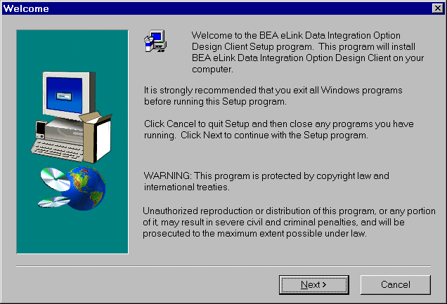

client/eLnkClnt directory and select the Setup.exe program. Click
OK to run the executable and begin the installation. The following Welcome
screen displays. Click Next to continue with the installation.
Figure 3-1 Welcome

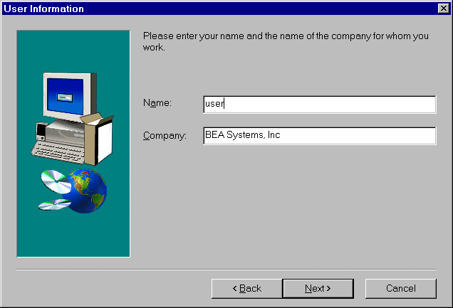

Figure 3-2 User Information
Figure 3-3 User Information

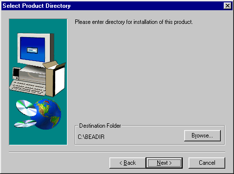

Figure 3-4 Select Product Directory

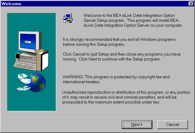

server/winnt directory and select the Setup.exe program. Click OK
to run the executable and begin the installation. The following Welcome screen
Figure 3-6 Welcome

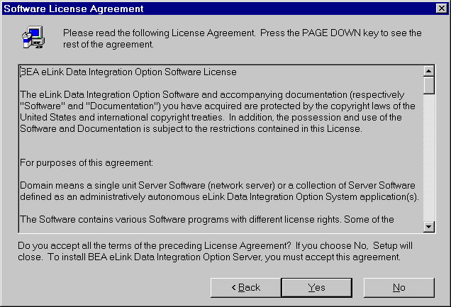

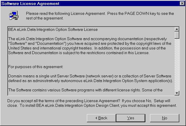

Figure 3-7 Software License Agreement
Figure 3-8 User Information

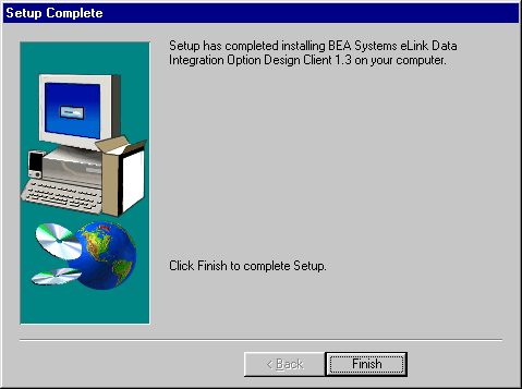

When the installation completes, the Setup Complete screen shown in Step 6 notifies you that the eLink DIO Server software is installed on your system.

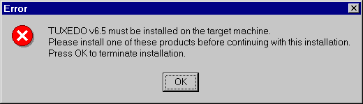

If BEA TUXEDO is not installed on your system, the following Error screen displays.
Warning:
If Windows NT is your execution environment, BEA TUXEDO should be installed first and the eLink DIO Server should be installed within the same directory. If you install the eLink DIO Server outside of the TUXEDO directory, you will need to copy the files into the TUXEDO directory for processing of data mapping service requests.
Click OK to terminate the installation process.
Figure 3-9 Error

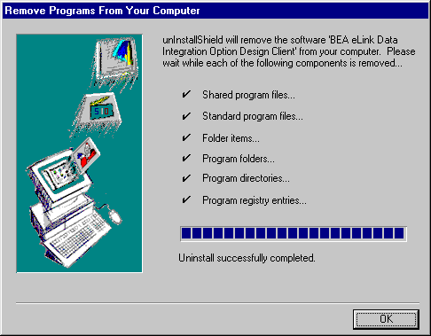

Perform the following steps to uninstall the eLink DIO software on a Windows NT system:
