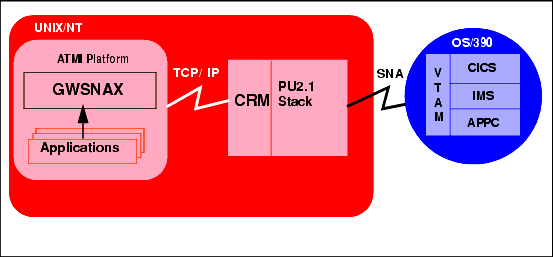

The local configuration, illustrated in Figure 1-1, combines the applications, eAM gateway, ATMI platform, and the CRM with the stack (PU2.1 server) on the same UNIX or Windows NT platform. It employs the IBM proprietary SNA protocol for communication with the mainframe via the stack.
Figure 1-1 eAM Local Configuration

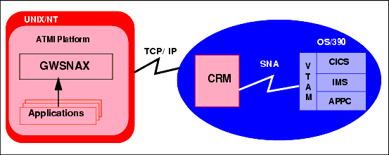

One type of distributed configuration separates the applications and the eAM gateway on a UNIX or Windows NT platform from the CRM by installing the CRM on the IBM OS/390 Mainframe. See Figure 1-2. This configuration eliminates the need for a third-party stack on the UNIX or NT machine. Note that this configuration requires a one-to-one relationship between the local eAM gateway and the remote CRM.
Figure 1-2 eAM Distributed Configuration

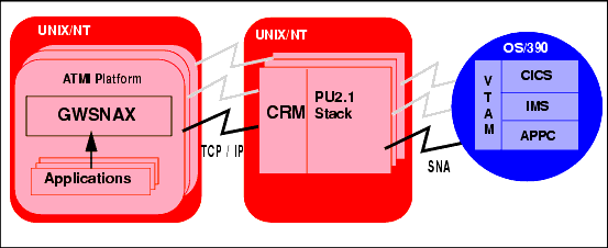

Another type of distributed configuration separates the applications and the eAM gateway from the CRM on different UNIX or Windows NT platforms. See Figure 1-3. This configuration employs Transmission Control Protocol/Internet Protocol (TCP/IP) connectivity between the applications platform and the CRM platforms, as well as the SNA connectivity to the mainframe environment(s). It provides the flexibility to deploy the ATMI platform separately from the CRM with installations that require the ATMI platform on a platform other than the one on which the SNA stack is running. Note that this configuration requires a one-to-one relationship between the local eAM gateway and the remote CRM.
Figure 1-3 Alternate eAM Distributed Configuration
