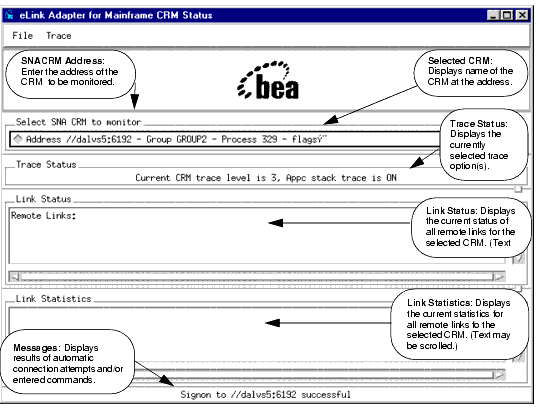

Using the CRM Monitor and the xsnacrm Utility
The xsnacrm utility provides realtime monitoring of the CRM and displays information describing the activity occurring in each CRM. The xsnacrm utility should be used by administrators and system operators only. Access to this utility may be restricted by setting the execute permissions during installation. The xsnacrm utility requires Motif libraries.
To launch and execute the CRM monitor using the xsnacrm utility, perform the following steps:
The APPC Protocol Stack API trace is either enabled or disabled. If enabled, it generally shows the parameters and results of all API calls. Depending on the Stack being used, other options (such as vendor-specified environment variables) may have to be activated for SNACRM to enable the trace.
At least one address must be specified. Multiple CRMs may be monitored by specifying all their associated addresses.
The format of an address consists of two forward slashes (//) followed by a host name or address, a colon (:) , and a service name or decimal port number (containing no spaces).
If a host name is used, it should be an entry in the file /etc/hosts. If a host address is used, it should be specified in the format nnn.nnn.nnn.nnn where each group of nnn represents a decimal number between 1 and 255. This host should identify the computer where the CRM you wish to monitor is running, not the host where xsnacrm is to run.
If a service name is used, it should be an entry in the file /etc/services. If a decimal port number is used, it should be a decimal number in the range 4000 - 32767. This number must match the corresponding port number on the command line used to start the CRM you want to monitor. (If the CRM was started automatically, the address is specified in the DMCONFIG file).
xsnacrm [<X/Motif args>] <addr> [ <addr> ...]

Figure 3-1 illustrates the xsnacrm screen.
Figure 3-1 xsnacrm Screen

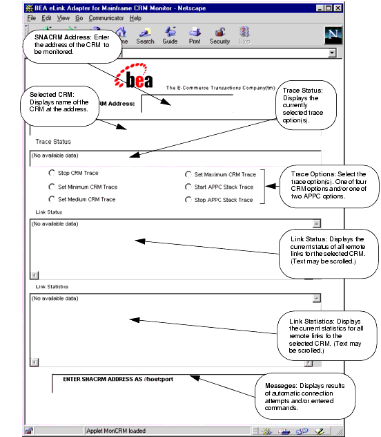

The CRM Monitor contains two screen areas that require user entry and four screen areas that display information about the CRM being monitored. Status messages are displayed at the bottom of the screen. The screen functions are listed in Table 3-1 and shown in Figure 3-2.
Display Section |
Function |
CRM Address |
Enter the address of the CRM to be monitored. |
Selected CRM |
Displays the name of the CRM at the address entered in the address field. |
Trace Status |
Displays the currently selected trace options. |
Trace Options |
Link Status |
Displays the current status of all remote links for the selected CRM. (Text may be scrolled.) |
Link Statistics |
Displays the current statistics for all remote links for the selected CRM. (Text may be scrolled.) |
Message Line |
Displays messages showing either the results of automatic connection attempts or commands issued to change the trace options. |
Figure 3-2 The CRM Monitor Running as an Applet on a Network Browser
