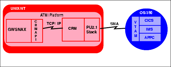

Local configuration combines the ATMI platform, the eAM gateway, CRM, and SNA stack (PU2.1 server) on the same UNIX or Windows NT platform, as shown in Figure 2-1. It features the widely used TCP/IP connectivity between the eAM gateway and CRM, giving a high-performance communications interface. On the mainframe side, the CRM uses a stack to communicate over a System Network Architecture (SNA) interface with the host system. This configuration allows you to:
Note: A one-to-one relationship exists between the eAM gateway and CRM. The eAM gateway cannot be configured to handle multiple CRM processes.
Figure 2-1 Local eAM Configuration on UNIX/NT Platform

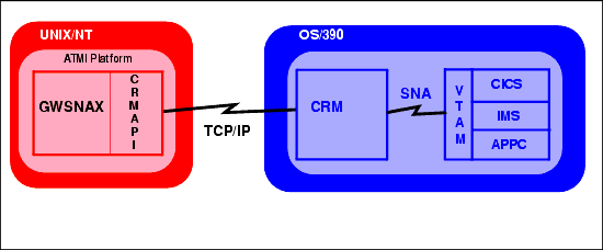

Distributed Configuration-CRM on OS/390 Host
This distributed configuration deploys the CRM to the OS/390 host system as shown in Figure 2-2. It employs TCP/IP connectivity with the host, eliminating the need for a local SNA stack. This configuration provides a faster network interface and is less complex than the local configuration.
Figure 2-2 Distributed CRM on OS/390 Platform

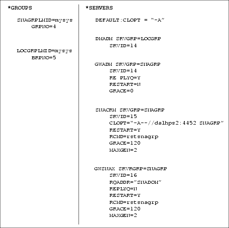

The UBBCONFIG file is an ASCII file that can be edited with any text editor. To edit the UBBCONFIG file, complete the following tasks:
Note: If the CRM is started as an ATMI process, it must precede the GWSNAX entry in the UBBCONFIG file.
Figure 2-4 Sample UBBCONFIG File Entries Specifying CRM as an ATMI Server
