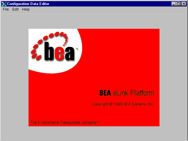

The Configuration Data Editor is a maintenance application that allows you to add or delete machines from the Configuration Data file as well as updating current information.

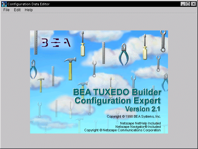

When you first bring up the Configuration Data Editor, the main window frame showing the Builder splash screen is displayed. This screen is similar to the Configuration Expert.
Figure 3-34 Initial Configuration Data Expert Window

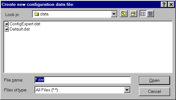

 To create a new configuration data file:
 Create a New Configuration Data File
 This brings up the Create new configuration data file browser window as shown in Figure  3-35.
Figure 3-35    Create New Configuration Data File
 The Configuration Data Editor main window is displayed.

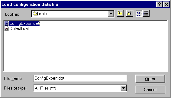

To open an existing configuration file:
 This brings up the Load configuration data file window.
Figure 3-37    Load Configuration Data File Window
 The Configuration Data Editor main window is displayed. See the section Modifying Data Using the Configuration Data Editor.

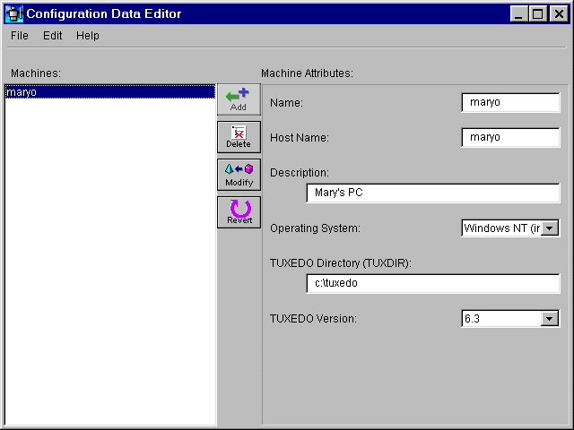

As shown in Figure 3-38, the Configuration Data Editor main window layout provides the following view:
Figure 3-38 Configuration Data Editor Main Window
The machines available in the Configuration Data file appear in the left panel, and the attributes that you want to modify appear in the fields in the right portion of the main window screen.
You can modify these attributes by selecting the specific machine you want to modify in the left panel, and filling in the appropriate information in the fields on the right.
The Configuration Data Editor has a main menu bar for general navigation commands such as Save, Add, and Delete, and the Data Configuration toolbar for editing the configuration data for each object (vertical).
The Data Configuration toolbar is in the middle of the main window. Table 3-20 describes the Data Configuration toolbar buttons available for frequently used actions.
 The following table explains each field on the right side of the Configuration Data Expert main window.

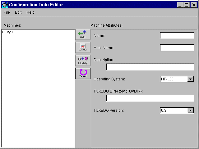

 To add a machine using the Configuration Data Editor:
 Add a Machine
 These are mandatory fields and the Add button is not activated until all fields are filled in.

 The newly added machine appears in the left panel of the Configuration Data Editor as shown in Figure  3-39. To modify this machine, see the task Modify a Machine.
 For each machine added to the repository, a set of default template resource managers is added. For more information on this file see Resource Manager Template File.
Figure 3-39    Add a Machine with Configuration Data Editor
