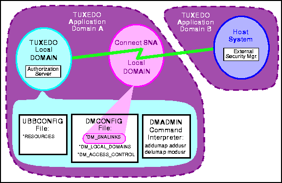

Security
DMADMIN
subcommands which you use to enter userids and passwords, set up mappings, remove mappings, remove userids and passwords, and modify passwords.
Figure 5-1 Connect SNA Security Elements
Where You Specify Security Parameters
