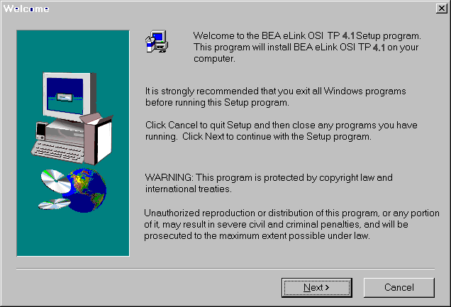

Figure 1-1 Welcome Window

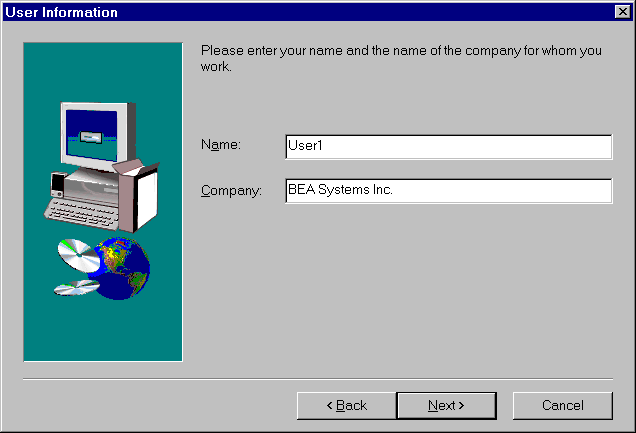

Figure 1-3 User Information Window

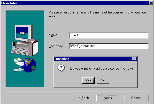

Note: If you click Yes, the BEA eLink OSI TP license file is appended to the existing Tuxedo license file, $TUXDIR\udataobj\lic.txt. If you click No, you will need to manually add the eLink OSI TP license to the end of the lic.txt file. Figure 1-4 Install License File Question

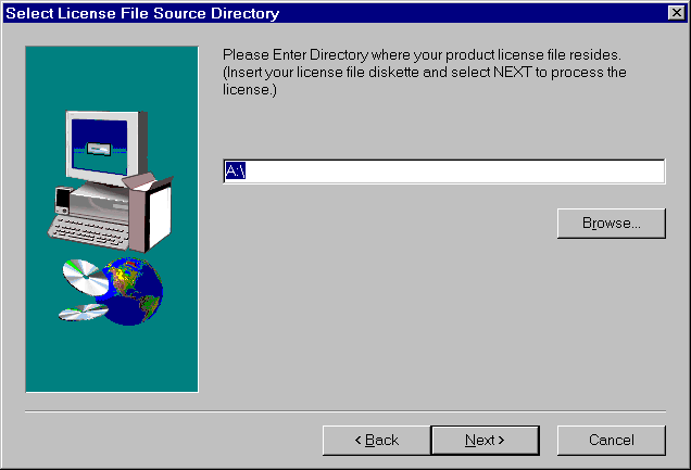

Figure 1-5 Select License File Source Directory Window

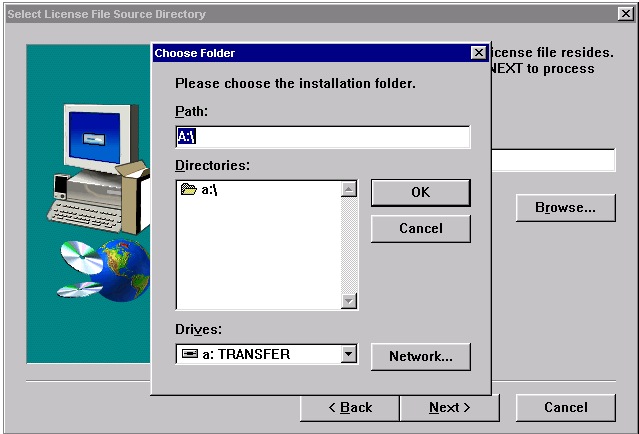

Figure 1-6 Choose Folder Pop-up Window
Note: During the eLink OSI TP installation, the $TUXDIR\udataobj\DMTYPE file is updated to include an OSITPX entry if one is not already there.

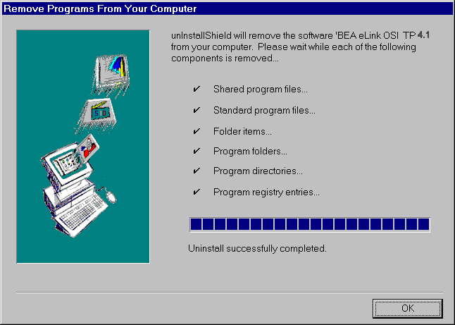

Uninstalling eLink OSI TP Product on Windows 2000
Perform the following steps to uninstall eLink OSI TP on a Windows NT system:
Note: Make sure that BEA eLink OSI TP is shut down before you uninstall.
Figure 1-8 Remove Programs From Your Computer Screen
