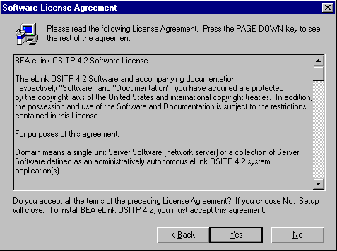

  3. Click Next to continue with the installation. The License Agreement window displays as shown in Figure 1-2.
    Figure 1-2 License Agreement Window
  4. Read the license agreement information, and click Yes to continue with the installation.

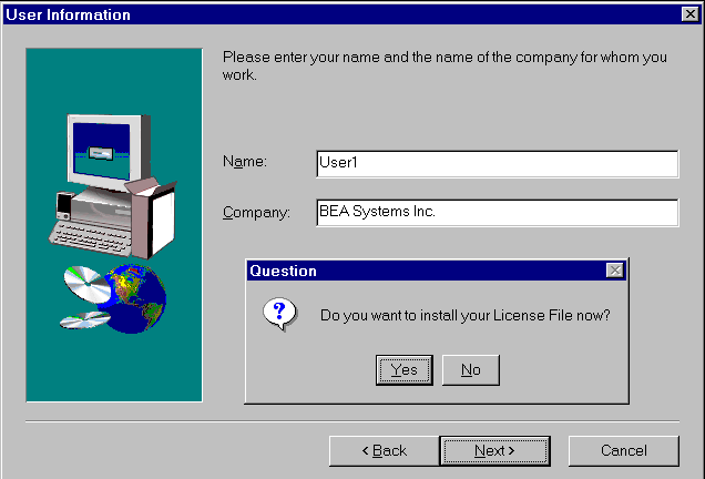

  5. The User Information window displays as shown in Figure 1-3. Enter your name in the Name field. Enter the name of your company in the Company field. Click Next to continue with the installation.
    Figure 1-3 User Information Window
  6. The install license file Question pop-up window displays as shown in Figure 1-4. Click Yes to install your License File now.
    Note: If you click Yes, the BEA eLink OSI TP license file is appended to the existing Tuxedo license file, $TUXDIR\udataobj\lic.txt. If you click No, you will need to manually add the eLink OSI TP license to the end of the lic.txt file.
    Figure 1-4 Install License File Question

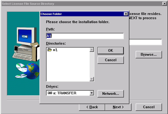

  7. When you click Yes to install the License File, the Select License File Source Directory window displays as shown in Figure 1-5.
    1. Enter the Directory and Path or click the Browse button to display the Choose Folder pop-up window as shown in Figure 1-6
      Figure 1-5 Select License File Source Directory Window
    2. If you clicked Browse, locate the License file and click OK to return to the Select License File Source Directory window. Then click Next to continue with the installation process.
      Figure 1-6 Choose Folder Pop-up Window

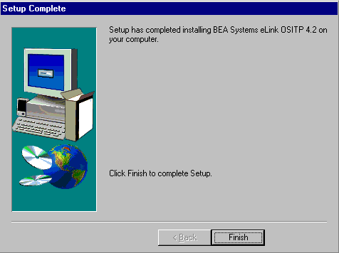

  9. The Setup Complete window, as shown in Figure 1-7 notifies you that the eLink OSI TP product is installed on your system. Click Finish to complete the setup process.
    Figure 1-7 Setup Complete

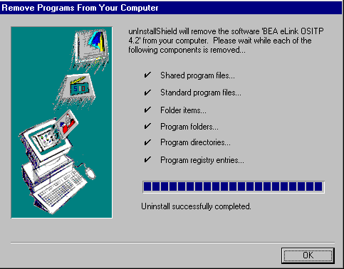

Uninstalling eLink OSI TP Product on Windows 2000
Perform the following steps to uninstall eLink OSI TP on a Windows NT system:
Note: Make sure that BEA eLink OSI TP is shut down before you uninstall.
  1. Click the Start button, and then point to Settings. Point to the folder that contains Control Panel, and then click Control Panel.
  2. Double click on the Add/Remove Programs option from the Control Panel listings to access the Add/Remove Programs properties window.
  3. In the Add/Remove Programs Properties window, select eLink OSI TP from the program list and click the Add/Remove button.
  4. The uninstall process for eLink OSI TP begins. The Remove Programs From Your Computer screen displays. Click OK to complete the uninstall process.
    Figure 1-8 Remove Programs From Your Computer Screen
