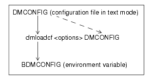

  5. Create or edit the DMCONFIG file with new gateway information. Refer to Implementing Native-A Encoding and Understanding the DMCONFIG File for more information.
  6. Generate a binary version of the dmconfig file by running the dmloadcf utility. Refer to Processing a Configuration File with the dmloadcf Utility for more information.
After you perform these steps, you are ready to start the gateway using the Tuxedo tmboot command. Refer to the BEA Tuxedo Online Documentation for more information about Tuxedo commands.

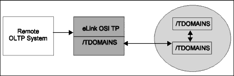

Using eLink OSI TP as a Pass-Through to Other Tuxedo Systems
For this example, the eLink OSI TP gateway acts as a pass-through to allow access to services on other Tuxedo systems. The eLink OSI TP gateway receives service requests from a remote OLTP system and then forwards them through the /TDOMAINS gateway to a remote Tuxedo system. The systems are as follows:
Figure 4-1 Example of eLink OSI TP Acting as a Pass-Through to Other Tuxedo Systems
Listing 4-7 shows a sample UBBCONFIG file and Listing 4-8 shows the corresponding DMCONFIG file for a pass-through configuration.

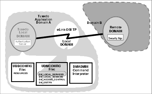

Setting up Security
BEA eLink OSI TP supports the following two types of security:
The BEA Tuxedo UBBCONFIG and eLink OSI TP DMCONFIG files include five sections in which you specify security parameters for whichever type of security you want to implement:
The following figure shows the relationships between security elements for eLink OSI TP.
Figure 4-2 eLink OSI TP Security Elements
Enabling Link Layer Security
To enable security, both the local and remote domains must support security. For Link Layer Security (LLS), the administrator must define the SECURITY in the *LOCAL_DOMAINS section as DM_PW and the OPTIONS parameter in the DM_OSITPX section must be set to SECURITY_SUPPORTED. The Local and Remote domain passwords should be set by the administrator through the dmadmin command passwd.
Whenever Link Layer Security is defined for the local domain and the remote domain, the passwd entered through dmadmin is hashed with a private key. The hashed value and private key are sent to the remote domain where it is compared with the hashed passwd on the remote system. This is a challenge response mechanism used to secure connections with a remote domain.
Three sections in the DMCONFIG file contain parameters affecting how eLink OSI TP controls access to the local Tuxedo domain:
Caution: Do not delete the Tuxedo BDMCONFIG file. The DM_PW information will be lost if the file is deleted. When new passwords are entered, the GWOSITP service must be shut down and restarted for the passwords to take effect.
Refer to Enabling Tuxedo Authentication for more information about Tuxedo security.
The following sample is a DMCONFIG file that defines the necessary parameters for establishing Link Layer Security.
The dmloadcf utility compiles the DMCONFIG file and creates a binary configuration file, BDMCONFIG, which is used by the DMADM server to control the run-time environment.
Figure 4-3 shows how the dmloadcf utility processes the configuration file. A description of the process follows the figure.
Figure 4-3 dmloadcf Process
Invoking the dmloadcf Utility
The dmloadcf utility is invoked from a command line with the following syntax:
dmloadcf [-c] [-n] [-y] [-b blocks] [-k] DMCONFIG_file
where the following options are valid:
-c
Prints minimum IPC resources needed for each local domain (gateway group) in this configuration. The BDMCONFIG file is not updated.
-n
Checks only the syntax of the ASCII DMCONFIG file without actually updating the BDMCONFIG file.
-y
Suppresses a prompt to create and initialize the BDMCONFIG file. This parameter must be entered before the DMCONFIG file name.
-b blocks
Indicates the number of blocks the device should use to create the Tuxedo file system. If the value of the -b option is large enough to hold the new BDMCONFIG tables, dmloadcf uses the specified value to create the new file system; otherwise, dmloadcf prints an error message and exits. If the -b option is not specified, dmloadcf creates a new file system large enough to hold the BDMCONFIG tables. The -b option is ignored if the file system already exists. The -b option is highly recommended if BDMCONFIG is a raw device (that has not been initialized) and should be set to the number of blocks on the raw device.
dmconfig_file
Specifies the name of the input configuration file to dmloadcf.
