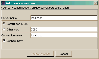

To create a new connection to WebLogic JRockit 7.0 JVM in the connection browser, do the following:
The Add new connection dialog box (Figure 3-8) appears:
Figure 3-8 Add New Connection Dialog Box

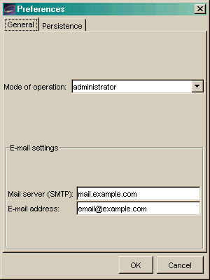

The Management Console can be run in two different operating modes:
To set the operation mode, do the following:
The Preferences dialog box (Figure 3-10) appears:
Figure 3-10 Preferences Menu (General Tab)
Figure 3-11 List of Operation Modes
Depending upon the mode to which you are toggling, the tabs on the console will change. See Figure 3-3 and Figure 3-4 for examples.
In addition to setting the operation mode, you can use the Preferences dialog box to change these settings:
To change either of these values, open the Preferences dialog box from the Tools menu and proceed are described in the following sections:

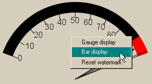

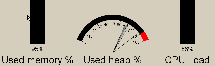

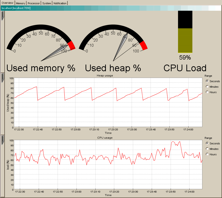

The gauges and bars are graphical devices showing memory and processor usage (Figure 3-14).
Figure 3-15 Gauge Context Menu (Bar Display Selected)
The selected gauge will appear as a bar (Figure 3-16).
Figure 3-16 Gauges and Bars with Gauge Converted to a Bar Display

The Overview tab (Figure 3-19) shows an overview of selected connections. To select more than one connection, select the folder containing the connections you want to view. They will appear simultaneously. The page is divided into a "dashboard" with gauges in the upper part and charts in the lower part.

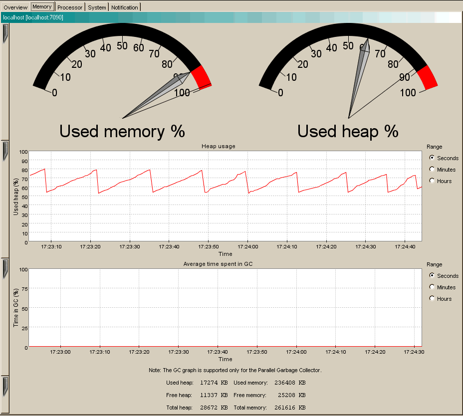

The Memory tab (Figure 3-20) shows information about the memory status of the system, as shown.
At the bottom of the page the following text information is displayed (in kilobytes):

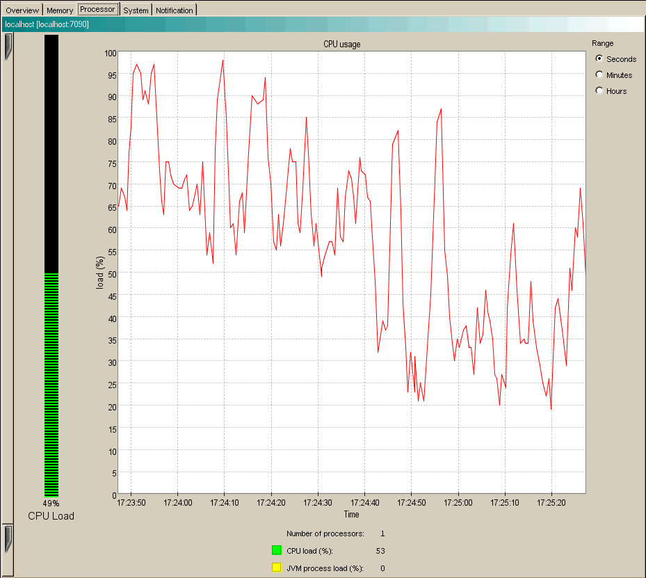

The Processor tab (Figure 3-21) shows information about the processor status of the system.
At the bottom of the page the following text information is displayed:

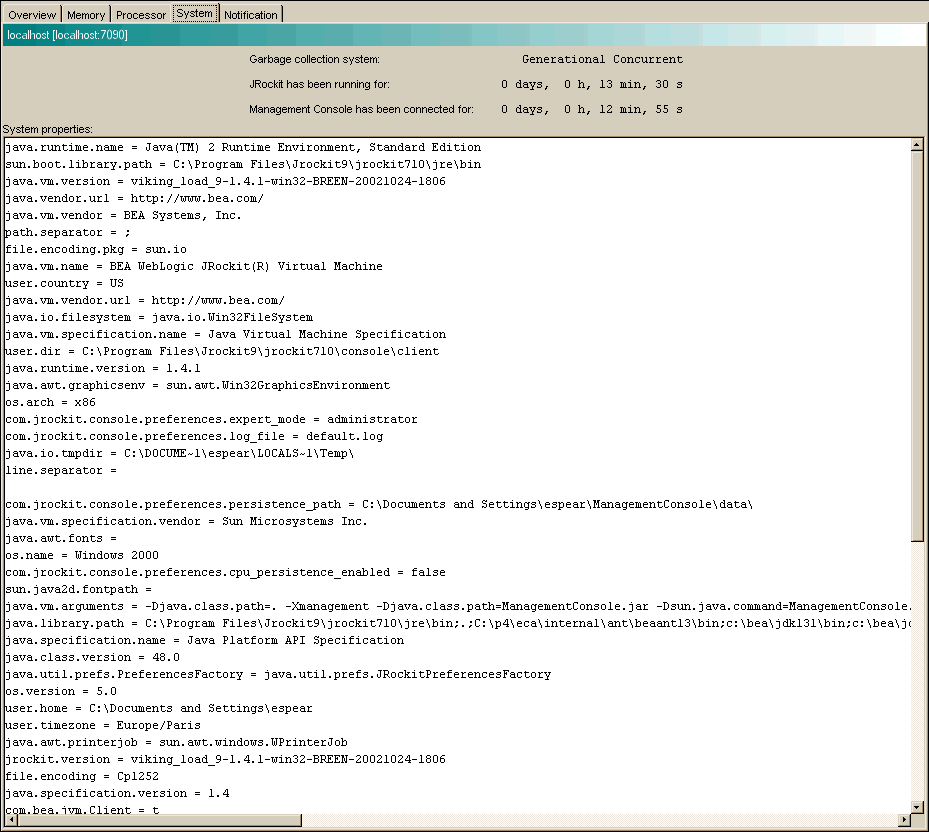

The System tab (Figure 3-22) shows various information about the system status.

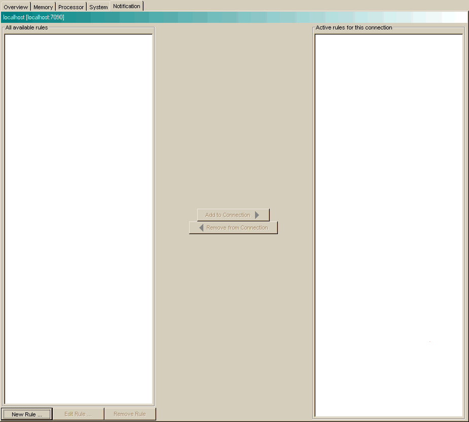

Use the Notification tab (Figure 3-23) to define alerts that notify users when certain events occur. You can create your own notification rules based on different triggers, with optional constraints, that alert you with a prescribed notification. This section describes how to create these rules.
Figure 3-23 Notification Tab (No Rules Defined)
A notification trigger can be a certain event, for example, that the connection to WebLogic JRockit 7.0 JVM was lost, or that an aspect reaches a certain value, for example, the used memory reaches 95%. A notification constraint can limit when a rule is triggered for example by not sending alerts at night or on certain dates.
The notification action is how the alert is communicated to the user. It can be one of the following:

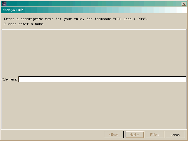

Rules determine when and how to issue a notification. To create a new rule, do the following:
The Name rule dialog box appears (Figure 3-24):
Figure 3-24 Name Rule Dialog Box

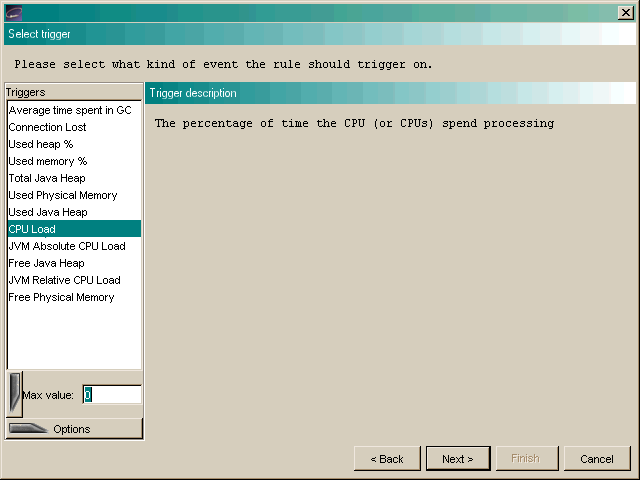

The Select trigger dialog box appears (Figure 3-25):
Figure 3-25 Select Trigger Dialog Box
Figure 3-26 Trigger Threshold and Options Text Boxes

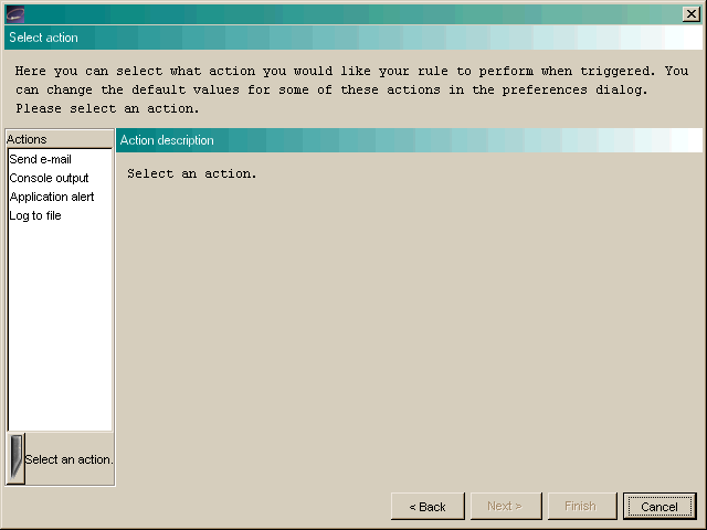

The Select Action dialog box appears (Figure 3-27):
Figure 3-27 Select Action Dialog Box

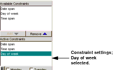

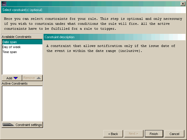

The Add Constraint dialog box appears (Figure 3-28):
Figure 3-28 Add Constraint Dialog Box
The constraint name will appear in the add list, as shown in Figure 3-29.

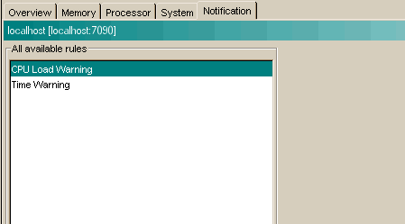

The new rule appears in the All available rules list on the Notification tab, as shown in Figure 3-30.
To edit a rule, do the following:

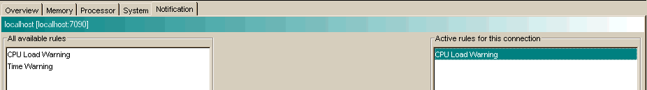

Add a Rule to WebLogic JRockit 7.0 JVM
To add a rule to WebLogic JRockit 7.0 JVM, do the following:
The rule appears in the Active rules for this connection list, as shown in Figure 3-31.
Figure 3-31 Rule Added to Active rules for This Connection List

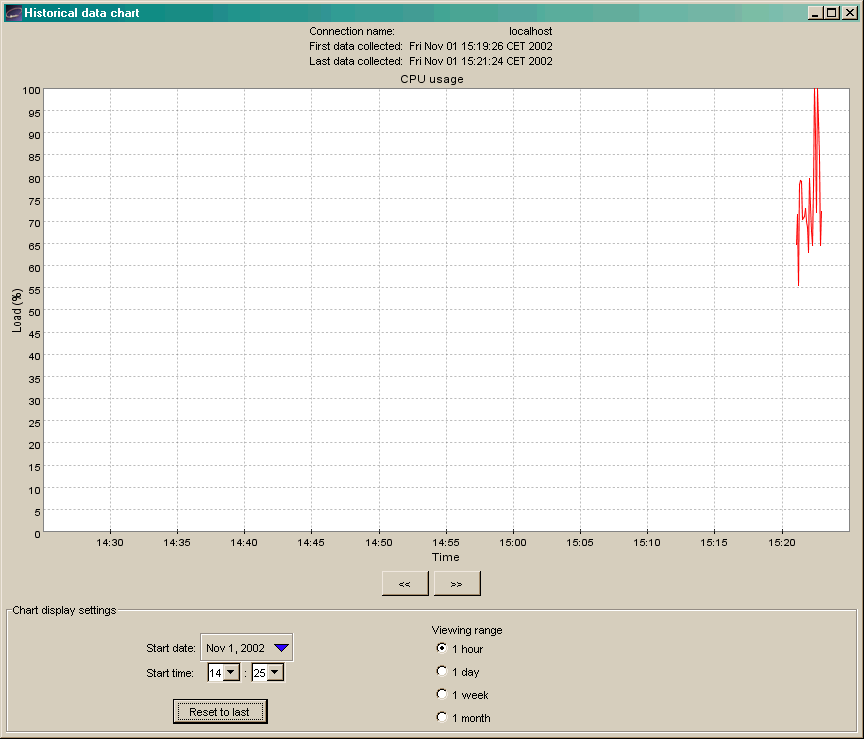

The historical data window displays a chart where historical data for an aspect can be viewed. This is useful for observing trends over time and, for example, finding when a server running with WebLogic JRockit 7.0 JVM has its peak loads.
To open this window, do the following:
Figure 3-32 View Menu with Historical Data Submenu Open
Historical data for the selected aspect appears (Figure 3-33).
Figure 3-33 Historical Data (CPU Load Selected)
To be able to observe historical data, aspect data from WebLogic JRockit 7.0 JVM must first have been persisted, that is, written to file. See Setting Other Preferences" on page 12 to enable or disable persistence. The following aspects are possible to persist, and thus display, historical data for:
As soon as data has been created by a connected connection, it is available for historical observation.

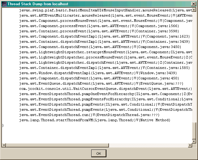

The stack dump contains a list of all running threads in WebLogic JRockit 7.0 JVM with a method call stack trace for each thread.
To view the thread stack dump, open the Tool menu and select View Thread Stack Dump. A dialog box containing the stack dump appears (Figure 3-34).

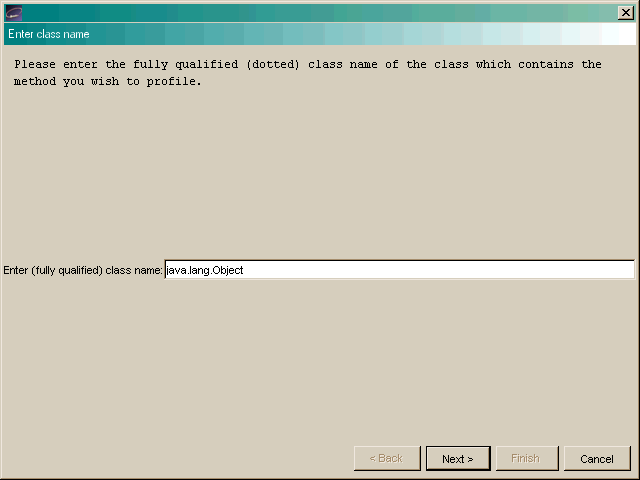

The Enter class name dialog box appears (Figure 3-35).
Figure 3-35 Enter Class Name Dialog Box

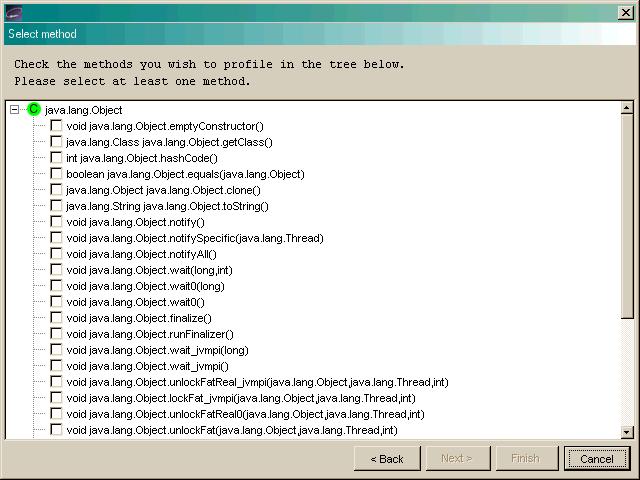

The Select method dialog box appears (Figure 3-36):
Figure 3-36 Select Method Dialog Box
The method name will appear on the Method profiling information list, as shown in Figure 3-37.

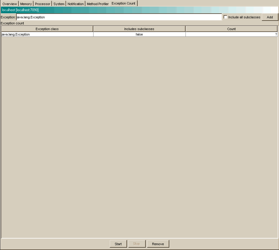

The Exception Count tab (Figure 3-39) shows exceptions thrown in WebLogic JRockit 7.0 JVM. It counts the number of exceptions of a certain type thrown.
Figure 3-39 Exception Counting Tab
To add an exception to observe, do the following:
The exception should now be displayed in the table.
Starting, Stopping, and Removing an Exception Count
To start the exception count, click Start. The results should now appear next to the name of the exception being counted. Similarly, to stop the exception count, click Stop.
To remove an exception from the count, select the exception to be removed and click Remove.
