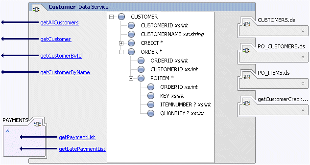

The sample is written against the data service shown in Figure 6-1.
Figure 6-1 Data Service Design
The data type for the Customer data service is CUSTOMER. A data type is a structured XML document, in this example composed of properties such as customer ID, name, and orders. The data for a CUSTOMER instance comes from four other data services, CUSTOMERS.ds, PO_CUSTOMERS.ds, PO_ITEMS.ds, and getCustomerCredit.ds (although the details of the composition of the data service do not need to be of concern to the data service user).
The sample Customer data service has several methods for getting data type instances, including getCustomer(), getCustomerById(), getPaymentList(), and so on. The function getPaymentList() is a navigation function. It does not return a CUSTOMER document; instead it returns data from a data service for which a logical relationship has been defined. In the case of getPaymentList(), the related data service named PAYMENTS returns the payment history for a given customer.
The navigation function makes it easy for client applications to acquire additional related data that is likely to be of interest when working with CUSTOMER documents. With the same data service handle used to get a customer, they can get that customer's list of payments.

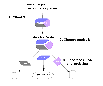

As it does for reading data, SDO gives client applications a unified interface for updating data. With Liquid Data, client application can modify and update data from heterogeneous, distributed sources as if the data were from a single entity. The complexity of propagating changes to diverse data sources is hidden from the client programmer. With a single update call, a client can propagate changes to a variety of data sources.
Data source updates occur in a transactionally secure manner; that is, given an update call that affects multiple sources, all updates to individual data sources within the update call either succeed or fail together. (Note that it is possible to override this behavior if needed.)
From the data service implementor's point of view, the task of building a library of update-capable data services is considerably eased by the Liquid Data update framework. For relational sources, Liquid Data can often propagate changes to the data sources automatically. For other sources, or to customize relational updates, you can use the Liquid Data update framework and tools to quickly implement a wide range of update-capable services.
As shown in the Figure 6-2, updates occur through a process in which the requested change is first analyzed to determine, among other things, the lineage of the data. The Liquid Data mediator then decomposes the submitted object into its constituent parts and propagates the changes to the data source.
At any point in this process, you can have your own code programmatically intervene, for example, to validate the update values or for auditing purposes.
For more information on updates, see the Liquid Data Application Developer's Guide.
