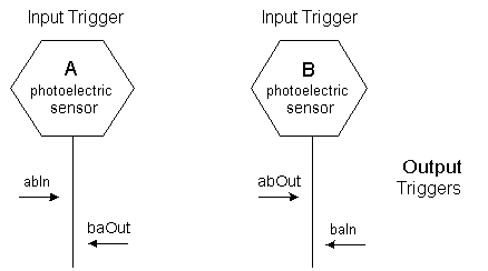

WebLogic RFID Edge Server includes a directional trigger driver that gets input from two source points, A and B, and determines if an object is moving from A to B or from B to A.
In the following example, two photoelectric sensors are positioned at a dock door, one at reading point A and one at reading point B. Tagged items move between points A and B in one direction at a time.
Figure 5-2 shows the input triggers, A and B, and the directional output triggers.
Moving items which first block photoelectric sensor A (generating output trigger abIn), then block sensor B (generating output trigger abOut), signal that AB traversal is finished. Moving items which block photoelectric sensor B first, then sensor A, (generating output triggers baIn then baOut), signal that BA traversal is finished.
Note: | There is a maximum allowed travel time (T) between point A and point B. The trigger driver resets to the idle state after travel time T elapses, even if an object moves past photoelectric sensor A (moves in) but fails to move past photoelectric sensor B at the exit point (does not move out). |
The directional trigger driver listens for input triggers. Input triggers might be PLC triggers, whose sources are PLC inbound messages which receive inputs from photoelectric sensors or other IO inputs, such as GPIO. Other types of triggers can also provide inputs, such as TCP triggers.
The directional trigger driver monitors the status (state change) of the input triggers, for example, when the photoelectric sensors are blocked. When the trigger driver receives the input trigger status, it generates trigger messages for trigger listeners in the event cycle, one listener for event start conditions and one for event stop conditions. When the start trigger is fired, the event cycle starts getting tag data; the event cycle stops when either the stop trigger fires or the cycle duration time expires.

The directional trigger driver generates four output trigger URIs; for example, door1:abIn
, door1:abOut
, door1:baIn
, door1:baOut
. You use the trigger URI to specify the starting condition (for example, door1
:abIn
) or stopping condition (for example, door1
:abOut
) in the event cycle definition.
Note: | abIn , abOut , baIn , and baOut are defined names and cannot be changed. |

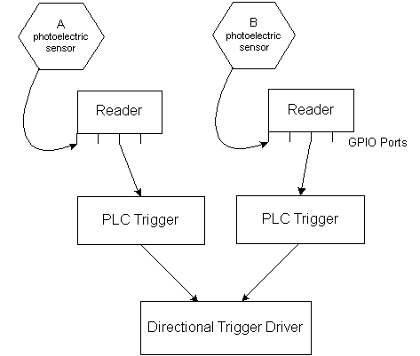

This example describes using the directional trigger driver with a Symbol XR400 reader (it does not work with the AR400 reader) and Symbol XR400 Reader Light Indication Box. Refer to the reader manufacturer's manual for the wiring details (Symbol Reader Manual, XR Series RFID Reader Integrator Guide, Part Number 72E-71773-03 Rev. A, February 2006).
Photoelectric sensors are connected to the Light Indication Box, then to the reader GPIO input ports (at pins #4 and #5). The GPIO port status is forwarded to the directional trigger driver using the Reader
type PLC transport and the simple
message convention.
To configure the directional trigger and the reader, perform the following steps:
edge.props
file, define the following properties (see Listing 5-2):enableGPIO
): true
.mygpio
(as defined in edge.props

The following example defines a directional trigger named door2 and uses two PLC IO inputs as input triggers. The PLC inputs are forwarded to the directional trigger driver using the ModBus
message convention. The RFID Edge Server communicates with the PLC using the Modbus protocol. See Controlling RFID Devices via PLC.
