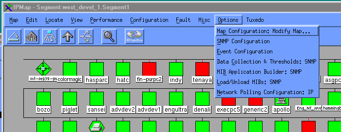

    1. Select Options-->Load/Unload MIBs: SNMP (Figure 3-1).
      Figure 3-1 Selecting Load/Unload MIBs in HP OpenView

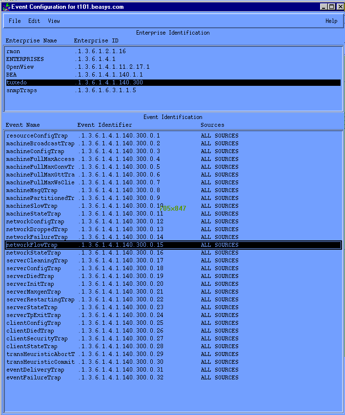

    1. Select Options-->Event Configuration.
    2. Select the enterprise tuxedo.
    3. Select an event type, such as networkFlowTrap in HP Open View.
    4. Customize the management framework response to incoming events of that type. Select Edit-->Modify Event in OpenView. This invokes the Event Configuration window (Figure 3-2).
      Figure 3-2 HP OpenView Event Configuration Window
      You can modify the event configuration to ignore an event, or generate a pop-up notification or run a program or script when the event is received. You might also want to create a separate category for Tuxedo events, as shown in this figure.
