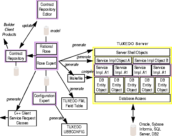

The Configuration Expert will import the Figure 1-2 provides an architectural overview of the relationship of the Rose Expert to the Configuration Expert, showing how you can use server data from the Rose Expert as input to the Configuration Expert.

You can export client/server interface contracts from the Rose Expert to the Contract Repository, thereby populating the Contract Repository with the data. This gives you the ability to share the BEA TUXEDO services modeled in the Rational Rose paradigm with the rest of the Builder development environment.
The code generated by the Rose Expert (C++ framework classes, makefile, FML field table) is essentially the same as the C++ Expert, but the interface contract source is the Rose model, not the Contract Repository (as it is for the C++ Expert).

gservers.lst file generated by the Rose Expert (as part of the framework classes source generation phase) as its source of server exectutable configuration information.
Figure 1-2 Using the Rose Expert with the Configuration Expert
