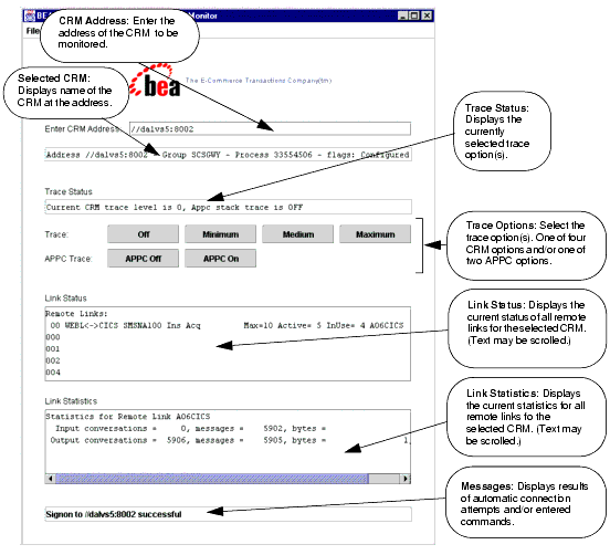

Using the CRM Monitor
The CRM Monitor is a Java application that allows you to connect to and monitor the CRM server through a graphical user interface (GUI). You can use the CRM Monitor to monitor link status and activity and start or stop diagnostic tracing of the CRM server. The CRM Monitor makes a network connection to the remote CRM server through a TCP/IP network connection. The CRM Monitor is installed with the Gateway, not on the mainframe.
Launching the CRM Monitor from the Windows Desktop
If the CRM Monitor is installed on Windows, a short cut is created in the Start menu of the Desktop when you install Tuxedo Mainframe Adapter for SNA.
To launch the CRM Monitor from the Desktop:
Launching the CRM Monitor from the Command Line
The CRM Monitor can also be started from the command line on UNIX
platforms.
To launch the CRM Monitor from the command line:
Setting CRM Monitor Options
Figure 2-1 shows an example of the CRM Monitor display.
Figure 2-1 CRM Monitor Display
CRM Monitor Display
After you launch the CRM Monitor, use the following instructions to set CRM Monitor options:
  1. To monitor a CRM, type the CRM address in the Enter CRM Address text box using the following format:
  2. //host:port
    where host explicitly specifies the CRM host machine and port specifies the port number of the CRM on the CRM host machine.
    This value may only be entered once per started instance of a CRM Monitor.
  3. Select one of the following trace options for the CRM:
  4. Select one of the following APPC stack trace options:
Note: Trace options for the CRM and APPC Stack API trace options may also be set from the CRM command. Refer to the CRM section for more information about trace options.
  1. After you enter a CRM address and select trace options, the following fields display information about the CRM you are monitoring:
  2. Display Field
    Description
    Selected CRM
    Displays the name of the CRM at the address entered in the address field.
    Trace Status
    Displays the currently selected trace options.
    Link Status
    Displays the current status of all remote links for the selected CRM. (Text may be scrolled.)
    Link Statistics
    Displays the current statistics for all remote links for the selected CRM. (Text may be scrolled.)
    Message Line
    Displays messages showing either the results of automatic connection attempts or commands issued to change the trace options.
