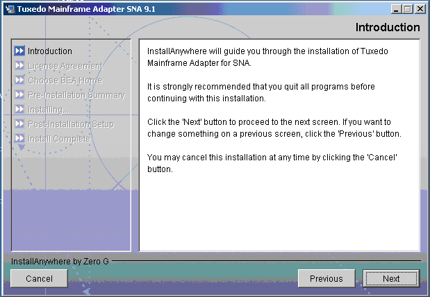

The Introduction screen (similar to Figure 3-1) displays.

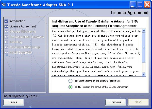

If you click the Do Not Accept option button, you will not be able to continue with the installation. You must either exit the installation or go back to the Introduction screen.

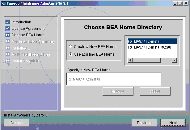

c:\bea). The BEA Home directory is the root directory in which you install all BEA products. This directory was set up when you installed Tuxedo.If you want to create a new BEA Home directory, follow these steps:
c:\bea, and your Tuxedo Mainframe Adapter for SNA software default installation directory will be the Tuxedo 9.1 Home directory.If you already have one or more BEA Home directories on your system, you can use one of those directories as follows:

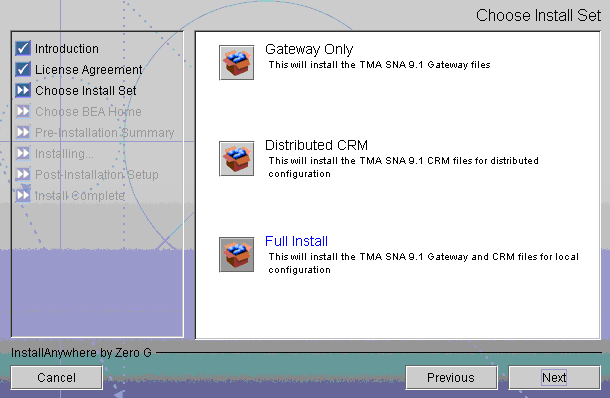

Choose Install Set
Please Choose the Install Set to be installed by this installer.
->1- Gateway Only
2- Distributed CRM
3- Full Install
ENTER THE NUMBER FOR THE INSTALL SET, OR <ENTER> TO ACCEPT THE DEFAULT: 3

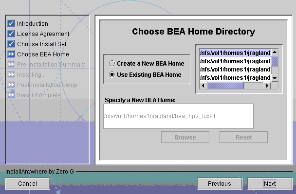

Choose BEA Home Directory
1- Create a New BEA Home
2- Use Existing BEA Home
Enter a number: 2
1- /bea
2- /bea/tuxedo9.1
Existing BEA Home: 1

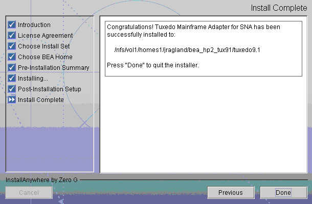

Perform the following steps to install the TMA SNA software in graphics mode on HP-UX 11.23:
$ su -
Password:
> mount -r -F cdfs /dev/cdrom/c1b0t0l0 /mnt
> cd /mnt/
# ls
tmasna91_32_aix_53_ppc.bin
tmasna91_32_hpux_1123_pa.bin
tmasna91_32_sol_9_sp.bin
tmasna91_32_SLES_9_x86.bin
mvs
/mnt/> sh tmasna91_32_hpux_1123_pa.bin

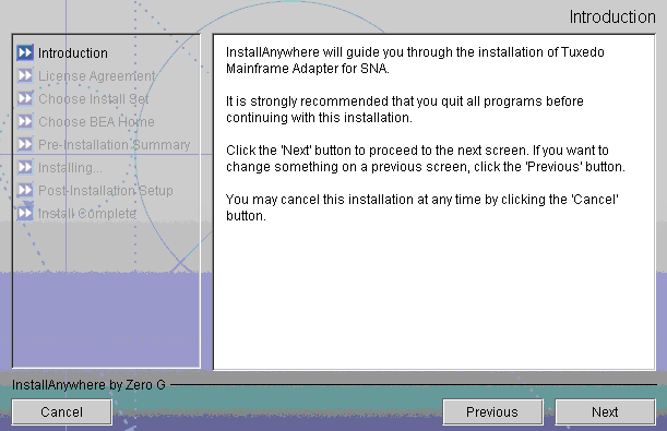

The Introduction screen (see Figure 3-7) displays.
| Note: | If you choose the Gateway Only or Full Install, the software will be installed in your tuxedo9.1 or tuxedo9.0 directory. If you choose to install the Distributed CRM, the software will be installed in the tmasna91 directory. |
From this message box, do one of the following:
