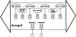

The basic unit of MessageQ system management is the message queuing
group. A message queuing group is a collection of message queues that
are used by an application and that share access to a local
interprocess communications (IPC) facility and MessageQ Servers. A
message queuing group can support more than one application. Message
queuing groups are connected to one another using cross-group
connections over network links.

The MessageQ environment consists of two kinds of processes:
All user processes in a MessageQ for OpenVMS message queuing group share several sections of global memory, run-time libraries (RTLs), and are served by the following MessageQ Server processes:
Figure 1-1 shows the servers and other process components of a message queuing group.
Figure 1-1 Components of a MessageQ Message Queuing Group
