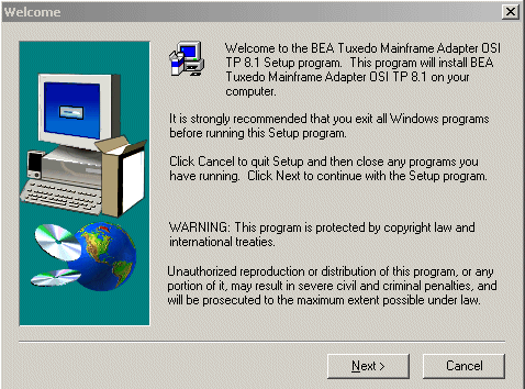

Perform the following steps to install the TMA OSI TP product on a Windows NT or Windows 2000 operating system:
Warning: For Windows operating systems, the BEA Tuxedo system should be installed first and the TMA OSI TP product should be installed within the same directory.
Note: If the Tuxedo product is NOT already installed on your system, an Error pop-up window displays. Click OK on the pop-up window to terminate the installation process. Install the Tuxedo product on your system and reinitiate the installation process.

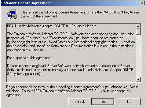

Figure 1-2 License Agreement Window

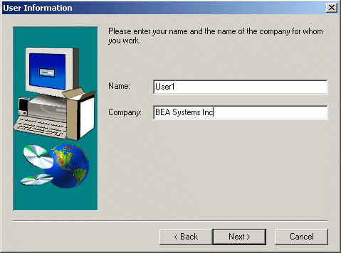

Figure 1-3 User Information Window

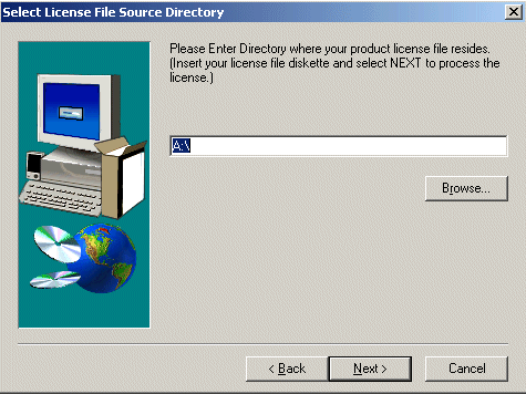

Note: If you click Yes, the BEA Tuxedo Mainframe Adapter for OSI TP license file is appended to the existing Tuxedo license file, $TUXDIR\udataobj\lic.txt. If you click No, you will need to manually add the TMA OSI TP license to the end of the lic.txt file.
Figure 1-4 Install License File Question

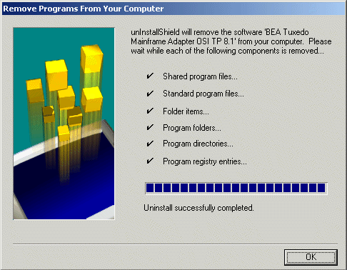

Perform the following steps to uninstall TMA OSI TP on a Windows NT system:
Note: Make sure that TMA OSI TP is shut down before you uninstall.
Figure 1-7 Remove Programs From Your Computer Screen
