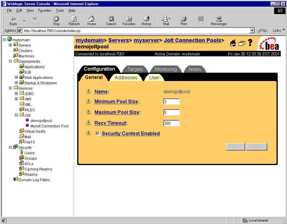

If you are connecting to a WebLogic Server that has Jolt correctly installed and configured, when you start the Administration Console you will see a configuration MBean for the Jolt connection pool displayed in the Administration Console, as shown in Figure 2-1.
For each Jolt connection pool there is an individual MBean that displays the pool name, maximum connections, pool state, and statistics about the connection status.

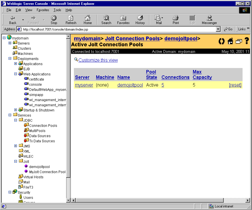

You can reset the Jolt connection pool without having to restart WebLogic Server. The resetConnectionPool() method calls the SessionPoolManager.stopSessionPool() method to shut down all the connections in the pool. It then calls the SessionPoolManager.createSessionPool() method to restart the connection pool.
The resetConnectionPool method can be invoked from the Administration Console command-line interface by using the following command:
java weblogic.Admin -url t3://localhost:7001 -username system -password gumby1234 -invoke -mbean mydomain:Name=myserver.jolt.demojoltpool,Type=JoltConnectionPoolRuntime,Location=myserver -method resetConnectionPool
The Jolt connection pool can also be reset from the GUI console by using the following method:
