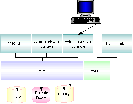

The Oracle Tuxedo system offers the following tools to monitor your application:
The Oracle Tuxedo system enables you to monitor system and application data.
To help you monitor a running system, your Oracle Tuxedo system maintains parameter settings and generates statistics for the following system components:
You can access these components using the MIB or tmadmin
. You can set up your system so that it can use the statistics in the bulletin board to make decisions and to modify system components dynamically, without your intervention. With proper configuration, your system can perform the following tasks (when bulletin board statistics indicate that they are required):
By monitoring the administrative data for your system, you can prevent and resolve problems that threaten the performance, availability, and security of your application.
To ensure that you have the information necessary to monitor your system, the Oracle Tuxedo system provides the following three data repositories:

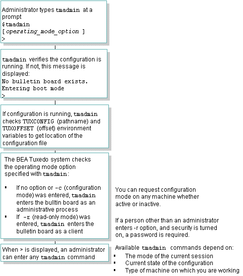

To monitor your application through the command-line interface, use the tmadmin(1) or txrpt(1) command.
The tmadmin
command is an interpreter for 53 commands that enable you to view and modify a bulletin board and its associated entities. Using the tmadmin
commands, you can monitor statistical information in the system such as the state of services, the number of requests executed, the number of queued requests, and so on.
Using the tmadmin
commands, you can also dynamically modify your Oracle Tuxedo system. You can, for example, perform the following types of changes while your system is running:
Whenever you start a tmadmin
session, you can choose the following operating modes for that session: the default operating mode, read-only mode, or configuration mode:
tmadmin
session, if you have administrator privileges (that is, if your effective UID and GID are those of the administrator).tmadmin
; the tmadmin
process attaches to the bulletin board as a client, leaving your administrator slot available for other work. tmadmin
session in configuration mode on any machine, including an inactive machine. On most inactive machines, configuration mode is required in order to run tmadmin
. (The only inactive machine on which you can start a tmadmin
session without requesting configuration mode is the MASTER
machine.)Note: | You can also generate a report of the Oracle Tuxedo version and license numbers. |

To help you identify error conditions quickly and accurately, the Oracle Tuxedo system provides the following log files:
TLOG
is created only on machines involved in Oracle Tuxedo global transactions.ULOGMILISEC
environment variable is used to time stamp ulog message output intervals in milliseconds instead of seconds. The ULOGRTNSIZE
environment variable is used to specify rotation files size. For more information on ULOGMILISEC
and ULOGRTNSIZE
, see userlog(3c) in the Oracle Tuxedo Command Reference.These logs are maintained and updated constantly while your application is running.
