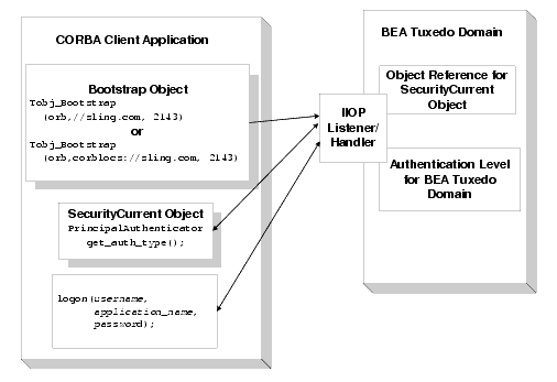

Figure 4-1 illustrates how CORBA security works in a BEA Tuxedo domain.
Tobj::PrincipalAuthenticator::get_auth_type() method to get the authentication level for the BEA Tuxedo domain.Tobj::PrincipalAuthenticator::logon() method to log on to the BEA Tuxedo domain with the proper authentication information.| Note: | BEA Tuxedo CORBA also supports the use of the CORBA Interoperable Naming Service (INS) to obtain an initial object reference for the Security Service. For information on the INS bootstrapping mechanism, see the CORBA Programming Reference. |

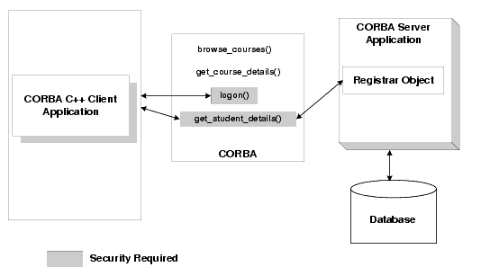

The Security sample application demonstrates how to use password authentication. The Security sample application requires that each student using the application has an ID and a password. The Security sample application works in the following manner:
logon() operation. This operation invokes operations on the PrincipalAuthenticator object, which is obtained as part of the process of logging on to access the domain.get_student_details() operation on the Registrar object to return information about a student. After the user is authenticated, logon is complete and the get_student_details() operation accesses the student information in the database to obtain the student information needed by the client logon operation.| Note: | Certificate authentication is illustrated in the Secure Simpapp sample application. |
Figure 4-2 illustrates the Security sample application.
The source files for the Security sample application are located in the \samples\corba\university directory in the BEA Tuxedo software. For information about building and running the Security sample application, see Using Security in CORBA Applications in the BEA Tuxedo online documentation.
