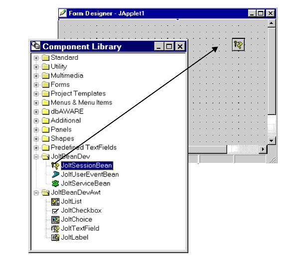

After you have set the CLASSPATH to include the Jolt classes, you can add JoltBeans to the Component Library of your development environment. See the documentation for your particular development environment for instructions on populating the Component Library.
When you are ready to add JoltBeans to the Component Library of your development environment, add only the development version of JoltBeans. Refer to Using Development and Run-time JoltBeans for complete details.

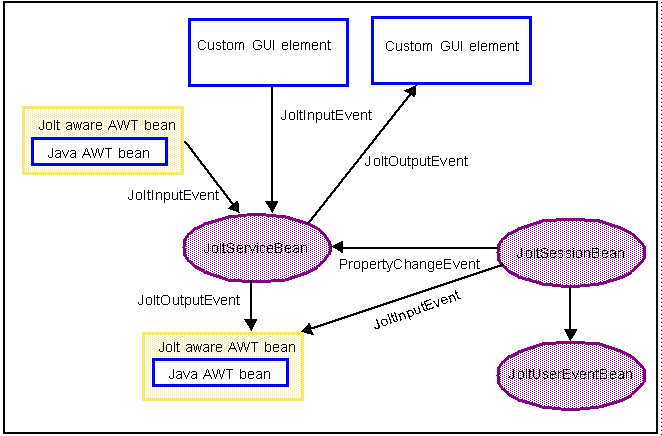

A Jolt client applet or application that is built using JoltBeans typically consists of Jolt-aware GUI beans, such as JoltTextField or JoltList, and JoltBeans, such as JoltServiceBean and JoltSessionBean. The main mode of communication between Beans is by JavaBeans events.
Jolt-aware beans are sources of JoltInputEvents or listeners of JoltOutputEvents or both. JoltServiceBeans are sources of JoltOutputEvents and listeners of JoltInputEvents.
The Jolt-aware GUI Beans expose properties and methods so you can link the beans directly to the parameters of an Oracle Tuxedo service (represented by a JoltServiceBean). Jolt-aware beans notify the JoltServiceBean via a JoltInputEvent when their content changes. The JoltServiceBean sends a JoltOutputEvent to all registered Jolt-aware beans when the reply data is available after the service call. The Jolt-aware GUI Beans contain logic that updates their contents with the corresponding output parameter of the service.
The following figure represents the possible relationships among the JoltBeans.

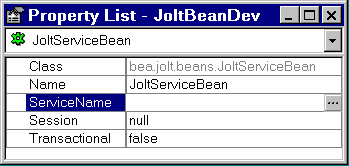

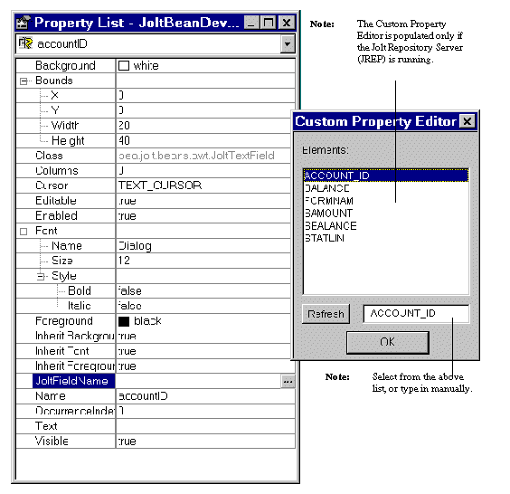

The values of most JoltBeans properties can be modified by editing the right column of the Property List in your integrated development environment (IDE), such as Visual Café, as shown in the following figure Property List: Ellipsis Button.

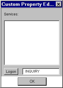

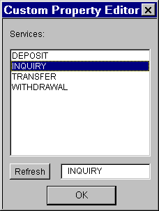

Custom property editors are provided for some properties of JoltBeans.
The custom property editors, accessed from the Property List, include dialog boxes that you use to modify the property values. You can invoke the custom property editors from the Property List by clicking the button with the ellipsis ( “...”) that is next to the value of the corresponding property value.
When you click the ellipsis button, the Property Editor shown in the following figure is displayed.
The Custom Property Editor of JoltBeans reads cached information. Initially, no cached information is available, so when the Property Editor is used for the first time, the dialog box is empty. Log on to the Jolt Repository and load the property editor cache from the repository.
For details about the logon and using the Property List and Property Editor, see Using the Jolt Repository and Setting the Property Values.

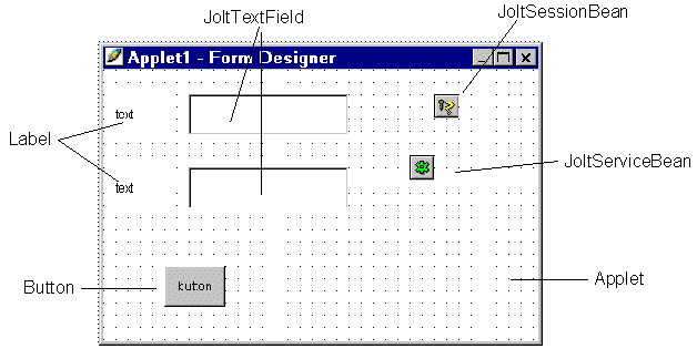

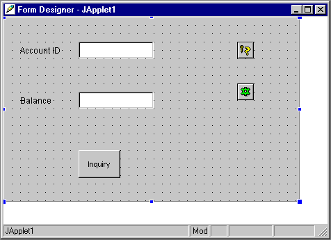

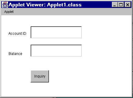

This walkthrough describes how to build an applet that you use to:

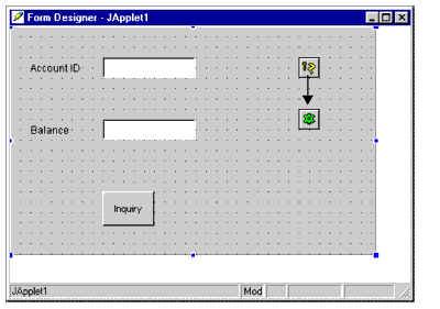

The following figure shows an example of a completed Java form containing JoltBeans. The applet implements the client functionality for the INQUIRY service of the BANKAPP sample that is included with Oracle Tuxedo. To run this sample, the Oracle Tuxedo server must be running.
Refer to the figure Visual Café 3.0 Form Designer for an example of each item required by the Java form. Each item in that figure is described in the following table Required Form Elements.
The sample form is created using an integrated development environment (IDE), in this example, Visual Café 3.0. The example demonstrates how to build an applet that allows you to enter an account ID and use an Oracle Tuxedo service to get and show the account balance.
Follow the basic steps below to create this sample.
New Project and select either JFC Applet or AWT application. This step provides you with the basic form designer on which you drop the JoltBeans.These steps are described in detail in the following sections.
| Note: | The graphic interface of previous versions of Visual Café differ from the look of Visual Café 3.0. You can complete this sample applet in a previous version of Visual Café; however, the steps executed in the Interaction Wizard differ slightly from this example. |
The following figure Visual Café 3.0 Form Designer illustrates how JoltBeans appear when they are placed on the palette of the Form Designer.

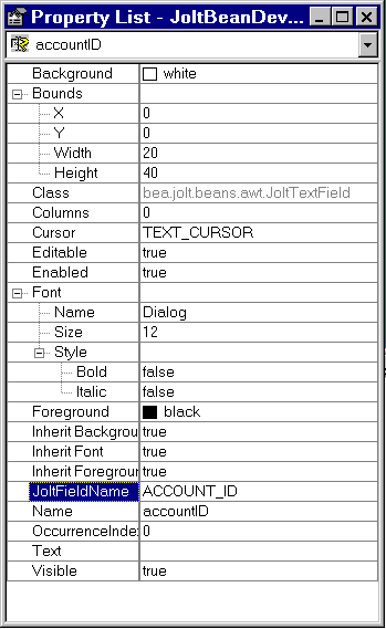

The following figure,Example of JoltTextField Property List and Custom Property Editor, shows how selecting the JoltFieldName of the button property list displays the Custom Property Editor.
| Note: | For complete information on setting and modifying the properties of the JoltBeans, refer to Using the Jolt Repository and Setting the Property Values. |
The following table specifies the property values that should be set. Values specified in bold and italic text are required, and those in plain text are recommended.
| Note: | In this walkthrough, the default occurrenceIndex of 0 works for both JoltTextFields. |
Refer to the following figure Example of JoltTextField Property List and Custom Property Editorand Using the Jolt Repository and Setting the Property Values for general guidelines about JoltBean properties.
The Custom Property Editor is displayed.
The change is reflected in the Property List shown in the following figure Revised JoltFieldName in the JoltTextField Property Listand on the text field shown on the figure Example of JoltBeans on the Form Designer with Property Changes.
| Note: | The properties that are visible in the Custom Property Editor are cached locally; therefore, if the source database is modified you must use the Refresh button to see the current, available properties. |
The following figure Example of JoltBeans on the Form Designer with Property Changes illustrates how the text on the button and the textfield changes after the text is added to the property list fields for these beans.

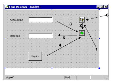

After all the beans are positioned on your form and the properties are set, you must wire the beans and their events together. The following figure Sequence in Which JoltBeans Are Wired illustrates an example of the flow to help you determine the correct order in which to wire the beans.
Wiring the beans allows you to establish event source-listener relationships between various beans on the form. For example, the JoltServiceBean is a listener of ActionEvents from the button and invokes callService() when the event is received. Use the Visual Café Interaction Wizard to wire the beans together.
The following figure shows the sequence in which you will wire the beans together to create this sample applet. The numbers in this figure correspond to the numbered steps that follow.
The steps below correspond to the callouts shown in the figure Sequence in Which JoltBeans Are Wired. Each of the steps below is detailed in the sections that follow.

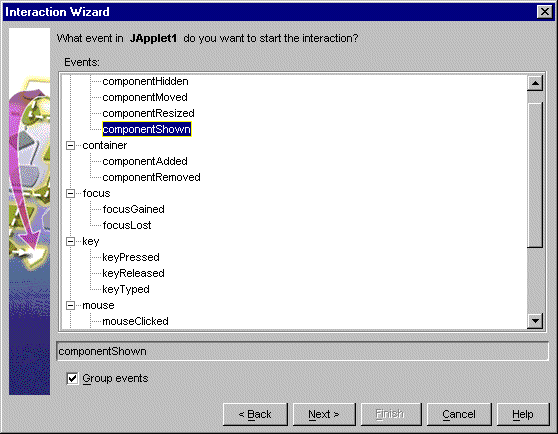

Step 1: Wire the JoltSessionBean Logon
Step 2: Wire JoltSessionBean to JoltServiceBean Using PropertyChange
Step 3: Wire the accountID JoltTextField as Input to the JoltServiceBean Using JoltInputEvent
Step 4: Wire Button to JoltServiceBean Using JoltAction
Step 5: Wire JoltServiceBean to the Balance JoltTextField Using JoltOutputEvent
Step 6: Wire the JoltSessionBean Logoff
Step 7: Compile the Applet (not shown as a callout)
The Interaction Wizard window is displayed as shown in the figure Select ComponentShown Event, with the prompt:
What event in JApplet1 do you want to start the interaction?
The Interaction Wizard window is displayed, as shown in the figure Select Logon to the Tuxedo System Action, with the prompt:
What do you want to happen when Japplet1 fires componentShown event?
Completing Step 1: Wire the JoltSessionBean Logon enables the logon() method of the JoltSessionBean to be triggered by an applet (for example, ComponentShown) that is sent when the applet is opened for the first time.

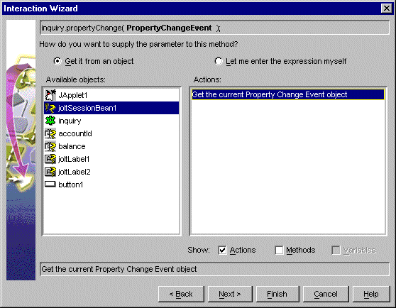

The Interaction Wizard window is displayed as shown in the figure Select propertyChange Event, with the prompt:
What event in joltSessionBean1 do you want to start the interaction?
The Interaction Wizard window is displayed as shown in the figure Select Handle a Jolt property change event..., with the prompt:
What do you want to happen when joltSessionBean1 fires propertyChange event?
The Interaction Wizard window is displayed as shown in the figure Select joltSesssionBean1, with the prompt:
How do you want to supply the parameter to this method?
and a list of available objects and actions from which to choose.
Completing Step 2: Wire JoltSessionBean to JoltServiceBean Using PropertyChangeenables the JoltSessionBean to send a propertyChange event when logon() completes. The JoltServiceBean listens to this event and associates its service with this session.

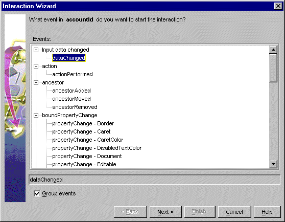

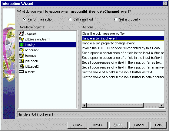

The Interaction Wizard window is displayed, as shown in the following figure, with the prompt:
What event in accountId do you want to start the interaction?

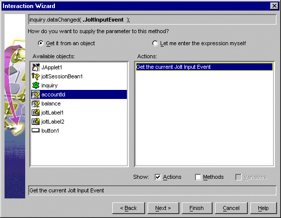

The Interaction Wizard window is displayed as shown in the figure Select inquiry Object and Handle a Jolt input event Action, with the prompt:
What do you want to happen when accountId fires dataChanged event?
Handle a jolt input event as the action, also as shown in the following figure.The Interaction Wizard window is displayed as shown in Select accountId Object and Get the current Jolt Input Event Action, with the prompt:
Completing Step 3: Wire the accountID JoltTextField as Input to the JoltServiceBean Using JoltInputEvent enables you to type the account number in the first text field. The JoltFieldName property of this JoltTextField is set to “ACCOUNT_ID”. Whenever the text inside this text box changes, it sends a JoltInputEvent to the JoltServiceBean. (The JoltServiceBean listens to JoltInputEvents from this text box.) The JoltInputEvent object contains the name, value, and occurrence index of the field.

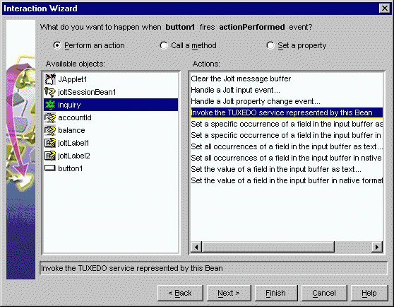

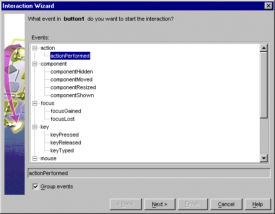

The Interaction Wizard window is displayed as shown in the following figure, with the prompt:
What event in button1 do you want to start the interaction?
The Interaction Wizard window is displayed, as shown in the figure Select inquiry Object and Invoke the TUXEDO Service... Action, with the prompt:
What do you want to happen when button1 fires actionPerformed event?
Completing Step 4: Wire Button to JoltServiceBean Using JoltAction enables the callService() method of the JoltServiceBean to be triggered by an ActionEvent from the Inquiry button.

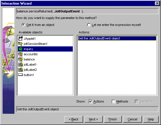

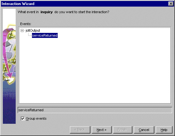

The Interaction Wizard is displayed, as shown in the following figure, with the prompt:
What event in inquiry do you want to start the interaction?
The Interaction Wizard window is displayed, as shown in the figure Select balance Object and Handle a service returned event Action, with the prompt:
What do you want to happen when inquiry fires serviceReturned event?
The Interaction Wizard window is displayed, as shown in the figure Select inquiry Object and Get the JoltOutputEvent object Action, with the prompt:
Completing Step 5: Wire JoltServiceBean to the Balance JoltTextField Using JoltOutputEventallows the JoltServiceBean to send a JoltOutputEvent when it receives reply data from the remote service. The JoltOutputEvent object contains methods to access fields in the output buffer. The JoltTextField displays the result of the INQUIRY service.

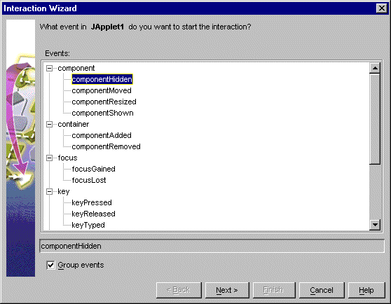

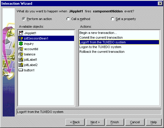

The Interaction Wizard window is displayed, as shown in the figure Select joltSessionBean1 Object and Logoff from the Tuxedo System Action, with the prompt:
What do you want to happen when JApplet1 fires componentHidden event?
Completing Step 6: Wire the JoltSessionBean Logoff enables the logoff() method of the JoltSessionBean to be triggered by an applet (for example, componentHidden) that is sent when the applet gets hidden.

Custom Property Editors are provided for the following properties:
The Property Editor, accessed from the Property List, includes dialog boxes that are used to add or modify the properties. You can invoke the boxes from the Property List by selecting the button with the ellipsis (...) that is next to the value of the corresponding property value.
Some JoltBeans require input to the Property List field. The beans are listed in the following table.
The property editor reads cached information from the repository and returns names of the available services and data elements in a list box. An example of the ServiceName property editor is shown in the following figure JoltServiceBean Property Editor.
To add or modify a property bean, follow these steps:
| Note: | If you cannot or do not want to connect to the Repository database, type the service name in the text box and skip to Step 7. |
The JoltBeans Repository Logon shown in the following figure is displayed.
The Custom Property Editor loads its cache from the repository and is displayed, as shown in the following figure Property Editor with Selected Service.
The bean property is set with the contents of the text box.

setTransactional (true) method is called on the JoltServiceBean. (isTransactional is a Boolean property of the JoltServiceBean.)beginTransaction() method is called on the JoltSessionBean. callService() method is called on the JoltServiceBean. commitTransaction() or rollbackTransaction()method is called on the JoltSessionBean.JoltBeans provides a limited set of Jolt-enabled GUI components. You can also use controls that are not Jolt-enabled together with the JoltServiceBean. You can link controls to the JoltServiceBean that display output information of the service represented by the JoltServiceBean. You can also link controls that display input information.
For example, a GUI element that uses an adapter class to implement the JoltOutputListener interface can listen to JoltOutputEvents. The JoltServiceBean as the event source for JoltOutputEvents calls the serviceReturned() method of the adapter class when it sends a JoltOutputEvent. Inside serviceReturned(), the control’s internal data is updated using information from the event object.
The development tool generates the adapter class when the JoltServiceBean and the GUI element are wired together.
As another example, a GUI element can call the setInputTextValue() method on the JoltServiceBean. The GUI element contains input data for the Oracle Tuxedo service represented by the JoltServiceBean.
As a third example, a GUI element can implement the required methods (addJoltInputListener() and removeJoltInputListener()) to act as event sources for JoltInputEvents. The JoltServiceBean acts as an event listener for these events. The control sends a JoltInputEvent when its own state changes to keep the JoltServiceBean updated with the input information.
