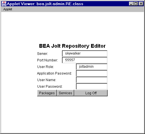

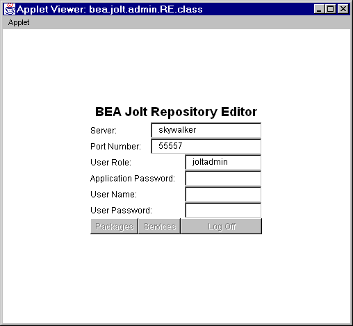

The window is displayed as shown in the figure Oracle Jolt Repository Editor Logon Window.

The editor is displayed as shown in Oracle Jolt Repository Editor Logon Window.

The Oracle Jolt Repository Editor Logon Window must be displayed before you continue with step 2. Refer to this figure as you perform the following procedure.
The system validates the server and port information.
| Note: | Unless you are logging on through the Jolt Relay, the same port number is used to configure the Jolt Listener. Refer to your UBBCONFIG file for additional information. |
Depending upon the authentication level, complete steps 5 and 6 as required.
The Packages and Services command buttons are enabled.
| Note: | See the JoltSessionClass for additional information. |
The following table, Repository Editor Logon Window Description, describes Repository Editor logon window elements.

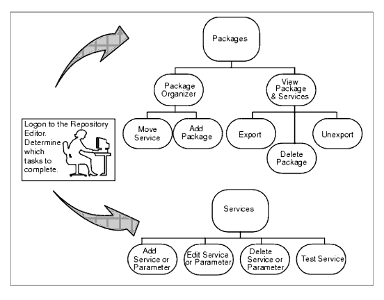

The Repository Editor allows you to add, modify, or delete any of the following components:
After you log on to the Repository Editor, two buttons are enabled, Packages and Services.
The following figure illustrates the Repository Editor flow to help you determine which of these two buttons to select.
Select Packages to open the Packages window and perform the following functions:
Refer to What Is a Package? for complete details.
Select Services to open the Services window and perform the following functions:
Refer to What Is a Service? for complete details.

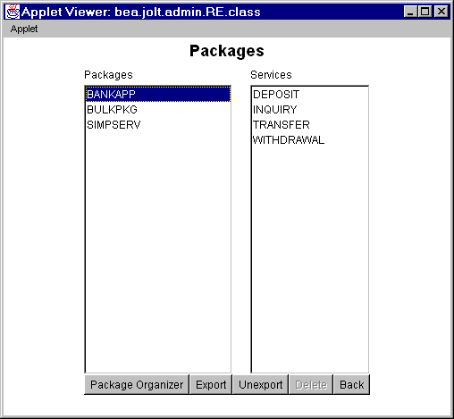

Packages provide a convenient method for grouping services for Jolt administration. (A service consists of parameters, such as pin number, account number, payment, rate, term, age, or Social Security number.)
You use the Packages window to perform the following:
Click the Packages button in the Jolt Repository Editor logon window to display the available packages. When you select a specific package from the display list, its services within that package are displayed.
The following figure contains a sample Packages window. The BANKAPP package is selected, and the services within the BANKAPP package is displayed.
The Packages window opens and displays the list of available packages.
In the figure Sample Packages Window, BANKAPP, BULKPKG, and SIMPSERV are the available packages.

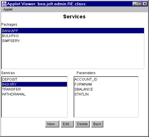

The following figure is an example of a Services window with the BANKAPP package selected, and the display list of services and parameters available for this package (parameters are detailed later).
The Services window opens and displays the list of available packages.
The list of available services for the selected package is displayed.
In the figure Sample Services Window, BANKAPP is the selected package. DEPOSIT, INQUIRY, TRANSFER, and WITHDRAWAL are the available services for BANKAPP.
A service contains parameters, which may be a pin number, account number, payment, rate, term, age, or Social Security number. The following figure shows a Services window displaying a selected service and its parameters.
| Note: | Adding or editing a parameter does not modify or change an existing Oracle Tuxedo Service. |
In the preceding figure, BANKAPP is the selected package.
The list of available parameters for the selected service is displayed.
In the preceding figure, INQUIRY is the selected service.
In the preceding figure, ACCOUNT_ID, FORMNAM, SBALANCE, and STATLIN are the available parameters for the INQUIRY service.

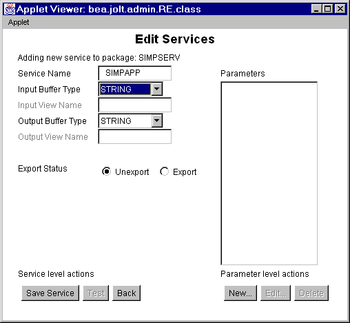

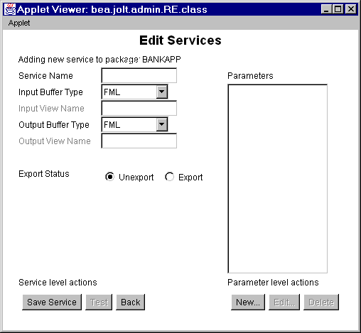

The following figure shows the Edit New Services window for adding a service.
The following table describes the options for adding services to a package in a package window.
VIEW— C-structure and 16-bit integer field. Contains subtypes that have a particular structure. X_C_TYPE and X_COMMON are equivalent. X_COMMON is used for COBOL and C.
VIEW32—similar to VIEW, except 32-bit field identifiers are associated with VIEW32 structure elements.
The Services window opens, similar to the figure shown in Sample Services Window.
If you later decide that another package should contain the new service, use the Package Organizer to move the service to a different package. (See Grouping Services Using the Package Organizer for additional information.)
Although the same buffer type selected for the Input Buffer is automatically selected for the Output Buffer, you can select a different Output Buffer type.
VIEW or VIEW32 is selected, you must type the Input View Name and Output View Name in the associated text fields. CARRAY or STRING is selected, refer to Selecting CARRAY or STRING as a Service Buffer Type for additional instructions.
If CARRAY or STRING is selected as the buffer type for a new service, only CARRAY or STRING can be added as the data type for the accompanying parameters. See also Adding a Parameter and Selecting CARRAY or STRING as a Parameter Data Type. For additional information, refer to Using the Jolt Class Library..
The following figure shows an example Edit Services window with STRING selected as the buffer type for the service SIMPAPP.

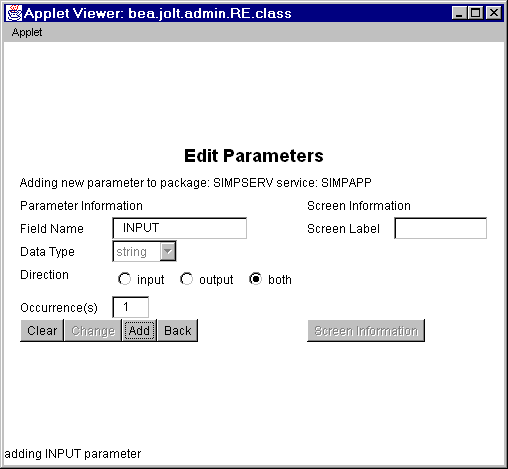

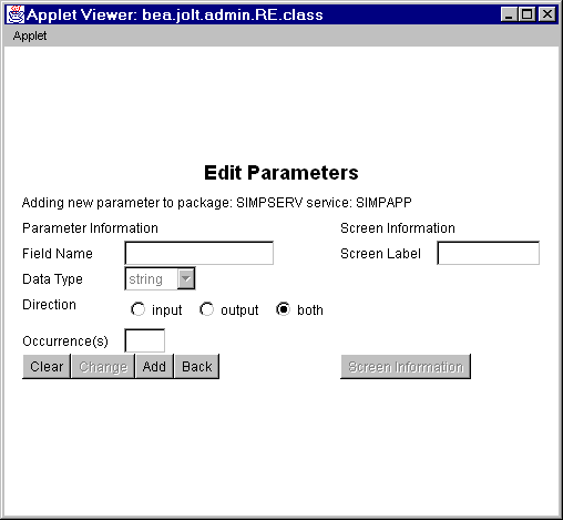

Clicking New under the label Parameter level actions in the Edit Services window is displayed in the Edit Parameters window. Review the features in the following figure. Use this window to enter the parameter and screen information for a service.
| Note: | If the buffer type is FML or VIEW, the field name must match the corresponding parameter field name in FML or VIEW. |
| WARNING: | If you do not click Save Service before you click Back, the parameters are not saved as part of the service. |
If CARRAY or STRING is the selected buffer type for a new service, only CARRAY or string can be added as the data type for the accompanying parameters.
In this case, only one parameter can be added. It is recommended that you use the parameter name “CARRAY” for a CARRAY buffer type, and the parameter name “STRING” for a STRING buffer type.
See also Instructions for Adding a Service and Selecting CARRAY or STRING as a Service Buffer Type. For additional information, refer to Using the Jolt Class Library..
The following figure is an example of the Edit Parameters window with string as the selected data type for the parameter. The Data Type defaults to string and does not allow you to modify that particular data type. The Field Name can be any name.

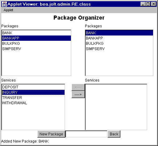

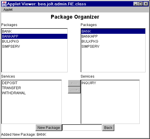

The Package Organizer moves services between packages. You may want to group related services in a package (for example, WITHDRAWAL services that are exported only at a certain time of the day can be grouped together in a package).
Use the Package Organizer arrow buttons to move a service from one package to another. These buttons are useful if you have several services to move between packages. The packages and services display listings to help track a service within a particular package.
The following figure is an example of a Package Organizer window with a service selected for transfer to another package.
In the previous figure, INQUIRY is the selected service in the BANKAPP package.
The previous figure shows the selected service, INQUIRY, and the selected package, BANK, to which the INQUIRY service will be moved.
These keys are activated only when both packages (left and right are displayed) and a service are selected. The keys are only active in the direction of the package where the service is to be moved. The previous figure, Example of a Moved Service, shows that the INQUIRY service has been moved to the BANK package on the right.
| Note: | You cannot select the same package in both the left and right display lists. |

The following figure shows the Packages window, where you can export and unexport services.
Follow these steps to export or unexport a service:
| Caution: | The system does not display a confirmation message indicating that the service is exported or unexported. See Reviewing the Exported and Unexported Status for additional information. |

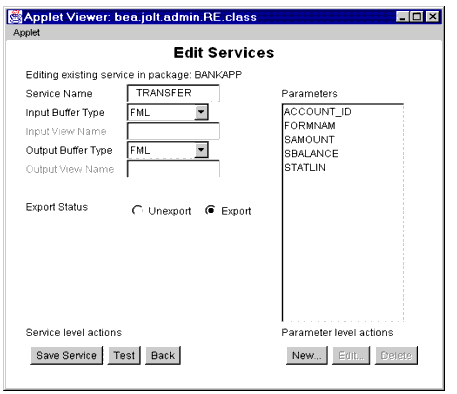

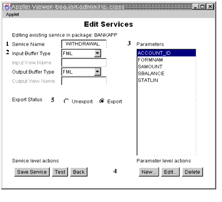

When a service is exported or unexported, you can review its status from the Edit Services window.
The following figure displays the Export radio button as active, for Export Status; therefore, the current status for the service TRANSFER is exported.
To review the current exported or unexported status of a service, follow these steps:
The Services display list of available services for the selected package is displayed.
The Edit Services window is displayed as shown in the figure Edit Services Window.
One of the radio buttons (Unexport or Export) next to the Export Status label will be active, indicating the current status of the service.

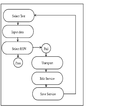

You can test a service without making changes to the service or its parameters. You can also test a service after editing the service or its parameters.
The following figure shows a typical Repository Editor service flow test.

Follow these steps if editing is required to pass the test:
