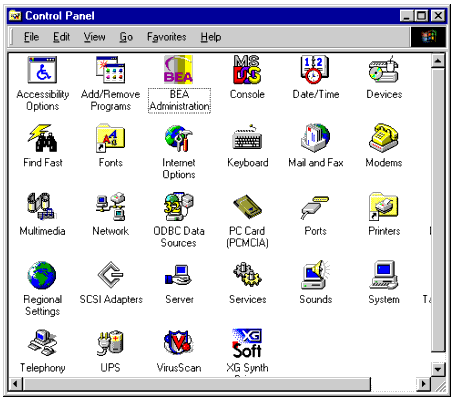

With Oracle Tuxedo release 7.1 or later software installed on your Windows Server 2003 system, perform the following steps to access the Oracle Administration program:
pls pay attention to this graph
You can use the Oracle Administration window to perform the following tasks:

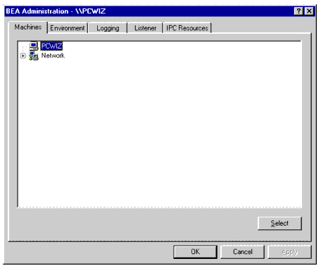

The Machines page of the Oracle Administration window enables you, as the Oracle Tuxedo system administrator, to access any machine (where you have login privileges) on the Microsoft Windows Network running Microsoft Windows Server 2003. You can then set environment variables remotely; determine the location of Oracle Tuxedo event logging; add, remove, stop, or start tlisten services; and tune IPC resources.
To access a remote machine, locate and click the machine’s icon on the network tree. If you know the name of a remote machine, but do not know its work group, perform the following steps to select it:
At this point, all subsequent actions performed on other pages (Environment, Logging, Listener, and IPC Resources) in the Oracle Administration window will take place on the selected machine (intrepid in this example).

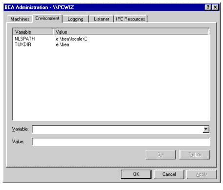

The Environment page enables you to view, set, or modify Oracle Tuxedo environment variables on your Windows Server 2003 system.
pls pay attention to the follow graph
To add, modify, or delete environment variables using the Environment page, follow these steps.

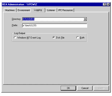

The Logging page enables you to direct Oracle Tuxedo system messages to the Event Log on your Windows Server 2003 system, to the traditional user log (ULOG) disk file, or both.
You may select the Event Log option, the traditional user log (ULOG) Disk File option, or both. No setup is required for the Event Log.
If you want to set up the traditional user log (ULOG) messages, perform the following steps to select a storage directory:

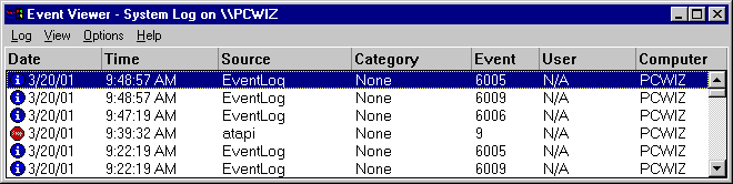

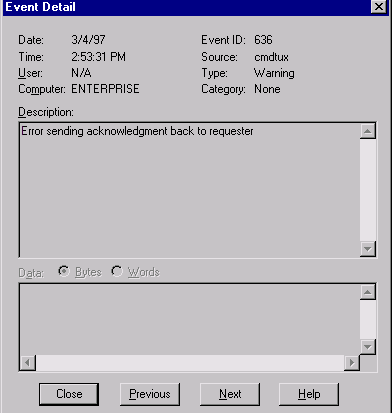

ULOG messages to be stored.ULOG, and the default file name is ULOG.mmddyy, where mmddyy is the month, day and year that the log file was created.To view Windows Server 2003 Event Log entries, follow these steps:
 Programs
 Programs  Administrative Tools
 Administrative Tools  Event Viewer to display a list of all the events that have occurred since the application booted.
 Event Viewer to display a list of all the events that have occurred since the application booted.This window provides the following information:
A ULOG is a text file. You can use any text editor to open a ULOG and view its contents.

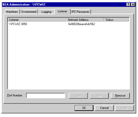

The Listener page enables you to view, create, or modify Tlisten services on your Windows Server 2003 system.
During the Oracle Tuxedo installation, the installer program installed a Tlisten service on your Windows Server 2003 system. Each time you boot your system, the Tlisten service starts a tlisten process on port 3050 of your machine. The password associated with the tlisten process is the one you entered during the installation.
A tlisten process must be started on each machine of a networked Oracle Tuxedo application before the Oracle Tuxedo system and application servers can boot. You use the tlisten process to perform administrative actions across multiple machines. To learn more about tlisten processes, see tlisten
(1)in Oracle Tuxedo Command Reference.
To add, remove, stop, or start Tlisten services using the Listener page, follow these steps.
tlisten process for each Oracle Tuxedo application running on your machine.)
Besides viewing and controlling Tlisten services using the Listener page, you can click Start  Programs
 Administrative Tools  Services to launch the Services window and then view and control Tlisten services via the Services window.

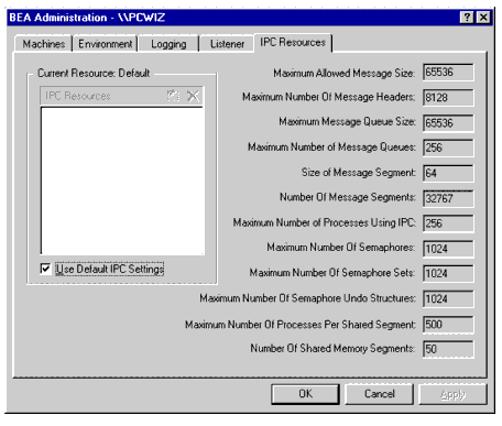

The IPC Resources page enables you to configure the interprocess communication (IPC) resources on your Windows Server 2003 system to maximize Oracle Tuxedo performance.
During the Oracle Tuxedo installation, the installer program installed an Oracle ProcMGR service on your Windows Server 2003 system. Each time you boot your system, the Oracle ProcMGR service configures the IPC resources on your machine to whatever values you set on the IPC Resources page. The values shown in the preceding display are the default IPC values set by the installer program.
On most machines, Oracle ProcMGR runs as installed; however, you can use the IPC Resources page to tune the IPC resources and maximize performance. To determine the minimum IPC Resource values required for an Oracle Tuxedo application, see the following table and “Checking IPC Requirements” in Installing the Oracle Tuxedo System. The following table maps the names of the IPC Resources on a Windows Server 2003 system to the traditional names on a UNIX system.
To modify IPC Resource values using the IPC Resources page, follow these steps:

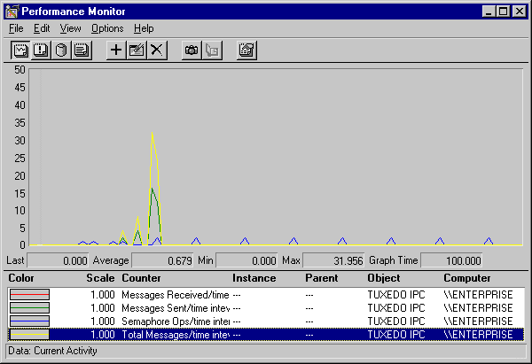

You can view the performance of a running Oracle Tuxedo application on the Windows Server 2003 Performance Monitor. Choose Start  Programs
 Programs  Administration Tools
 Administration Tools  Performance Monitor to launch the Performance Monitor window.
