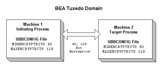

Figure 3-1 illustrates these steps.
When two processes at the opposite ends of a network link need to communicate, they must first agree on the size of the key to be used for encryption. This agreement is resolved through a two-step process of negotiation.
When either of the two processes starts up, the Oracle Tuxedo system (1) checks the bit-encryption capability of the installed LLE version by checking the LLE licensing information in the lic.txt file and (2) checks the LLE min-max values for the particular link type as specified in the two configuration files. The Oracle Tuxedo system then proceeds as follows:
min-max values accommodate the installed LLE version, then the local software assigns those values as the min-max values for the process.min-max values do not accommodate the installed LLE version, for example, if the Export LLE version is installed but the configured min-max values are (0, 128), then the local software issues a run-time error; link-level encryption is not possible at this point.min-max values specified in the configurations for a particular link type, then the local software assigns 0 as the minimum value and assigns the highest bit-encryption rate possible for the installed LLE versions as the maximum value, that is, (0, 128) for the Domestic LLE version.
After the min-max values are determined for the two processes, the negotiation of key size begins. The negotiation process need not be encrypted or hidden. Once a key size is agreed upon, it remains in effect for the lifetime of the network connection.
Table 3-1 shows which key size, if any, is agreed upon by two processes when all possible combinations of min-max values are negotiated. The header row holds the min-max values for one process; the far left column holds the min-max values for the other.

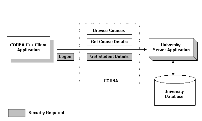

The CORBA security environment supports a password mechanism to provide authentication to existing CORBA applications and to new CORBA applications that are not prepared to deploy a full Public Key Infrastructure (PKI). When using password authentication, the applications that initiate invocations on CORBA objects authenticate themselves to the Oracle Tuxedo domain using a defined username and password.
The following levels of password authentication are provided:
When using Password authentication, you have the option of using the Tobj::PrincipalAuthenticator::logon() or the SecurityLevel2::PrincipalAuthenticator::authenticate() methods in your client application.
If you use password authentication, the SSL protocol can be used to provide confidentiality and integrity to communication between applications. For more information, see The SSL Protocol.
Password authentication works in the following way:
PrincipalAuthenticator object. The request for authentication is sent to the IIOP Listener/Handler. The proof material in the authentication request is securely relayed to the authentication server, which verifies the supplied information.Credentials object that is used by all future invocations. The Credentials object for the user is associated with the Current object that represents the security context.Figure 3-2 illustrates these steps.
Defining password authentication for a CORBA application includes administration and programming steps. Table 3-2 and Table 3-3 list the administration and programming steps for password authentication. For a detailed description of the administration steps for password authentication, see Configuring Authentication on page 7-1. For a complete description of the programming steps, see Writing a CORBA Application That Implements Security on page 9-1.

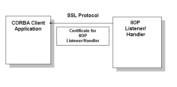

The Oracle Tuxedo product provides the industry-standard SSL protocol to establish secure communications between client and server applications. When using the SSL protocol, principals use digital certificates to prove their identity to a peer.
The default behavior of the SSL protocol in the CORBA security environment is to have the IIOP Listener/Handler prove its identity to the principal who initiated the SSL connection using digital certificates. The digital certificates are verified to ensure that each of the digital certificates has not been tampered with or expired. If there is a problem with any of the digital certificates in the chain, the SSL connection is terminated. In addition, the issuer of a digital certificate is compared against a list of trusted certificate authorities to verify the digital certificate received from the IIOP Listener/Handler has been signed by a certificate authority that is trusted by the Oracle Tuxedo domain.
Like LLE, the SSL protocol can be used with password authentication to provide confidentiality and integrity to communication between the client application and the Oracle Tuxedo domain. When using the SSL protocol with password authentication, you are prompted for the password of the IIOP Listener/Handler defined by the SEC_PRINCIPAL_NAME parameter when you enter the tmloadcf command.
The SSL protocol works in the following manner:
The initiating application can then use either password or certificate authentication to authenticate itself to the Oracle Tuxedo domain.
Figure 3-3 illustrates how the SSL protocol works.

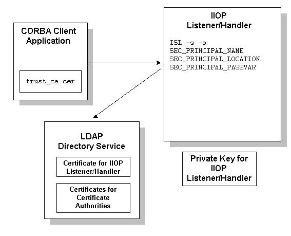

Using the SSL protocol in a CORBA application is primarily an administration process. Table 3-5 lists the administration steps required to set up the infrastructure required to use the SSL protocol and configure the IIOP Listener/Handler for the SSL protocol. For a detailed description of the administration steps, see Managing Public Key Security on page 4-1 and Configuring the SSL Protocol on page 6-1.
Once the administration steps are complete, you can use either password authentication or certificate authentication in your CORBA application. For more information, see Writing a CORBA Application That Implements Security on page 9-1.
| Note: | If you are using the Oracle CORBA C++ ORB as a server application, the ORB can also be configured to use the SSL protocol. For more information, see Configuring the SSL Protocol on page 6-1. |
If you use the SSL protocol with password authentication, you need to set the SECURITY parameter in the UBBCONFIG file to desired level of authentication and if appropriate, configure the Authentication Server (AUTHSRV). For information about the administration steps for password authentication, see Password Authentication.
Figure 3-4 illustrates the configuration of a CORBA application that uses the SSL protocol.

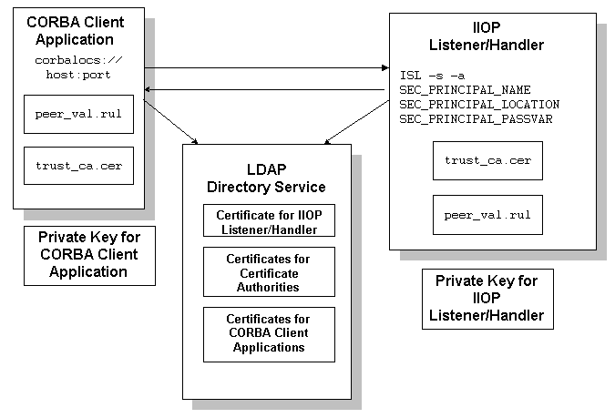

Certificate authentication requires that each side of an SSL connection proves its identity to the other side of the connection. In the CORBA security environment, the IIOP Listener/Handler presents its digital certificate to the principal who initiated the SSL connection. The initiator then provides a chain of digital certificates that are used by the IIOP Listener/Handler to verify the identity of the initiator.
Once a chain of digital certificates is successfully verified, the IIOP Listener/Handler retrieves the value of the distinguished name from the subject of the digital certificate. The CORBA security environment uses the e-mail address element of the subject’s distinguished name as the identity of the principal. The IIOP Listener/Handler uses the identity of the principal to impersonate the principal and establish a security context between the initiating application and the Oracle Tuxedo domain.
Once the principal has been authenticated, the principal that initiated the request and the IIOP Listener/Handler agree on a cipher suite that represents the type and strength of encryption that they both support. They also agree on the encryption key and synchronize to start encrypting all subsequent messages.
Figure 3-5 provides a conceptual overview of the certificate authentication.

Certificate authentication works in the following manner:
corbaloc://host:port or corbalocs://host:port and controls the requirement for protection by setting attributes on the SecurityLevel2::Credentials object returned as a result of the SecurityLevel2::PrincipalAuthenticator::authenticate operation.| Note: | You can also use the SecurityLevel2::Current::authenticate() method to secure the bootstrapping process and specify that certificate authentication is to be used. |
The security context is established as result of a SecurityLevel2::PrincipalAuthenticator::authenticate() method.
The IIOP Listener/Handler receives and validates the application’s digital certificate as part of the authentication process.
Credentials object. The Credentials object for the principal represents the security context for the current thread of execution.To use certificate authentication in a CORBA application, you need to install a license that enables the use of the SSL protocol and PKI. For information about installing the license, see Installing the Oracle Tuxedo System.

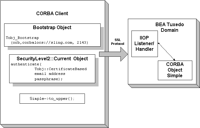

Using certificate authentication in a CORBA application includes administration and programming steps. Table 3-5 and Table 3-6 list the administration and programming steps for certificate authentication. For a detailed description of the administration steps, see Managing Public Key Security on page 4-1 and Configuring the SSL Protocol on page 6-1.
Figure 3-7 illustrates the configuration of a CORBA application that uses certificate authentication.
Table 3-6 lists the programming steps for using certificate authentication in a CORBA application. For more information, see Writing a CORBA Application That Implements Security on page 9-1.
Write application code that uses the
corbaloc or corbalocs URL address formats of the Bootstrap object. Note that the CommonName in the Distinguished Name of the certificate of the IIOP Listener/Handler must match exactly the host name provided in the URL address format. For more information on the URL address formats, see Using the Bootstrapping Mechanism.
You can also use the CORBA INS bootstrap mechanism to object a reference to a PrincipalAuthenticator object in the Oracle Tuxedo domain. For more information about using CORBA INS, see the CORBA Programming Reference.
