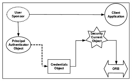

The CORBA security model is based on the process of authenticating principals to the Oracle Tuxedo domain. The objects in the CORBA security environment are used to authenticate a principal. The principal provides identity and authentication data, such as a password, to the client application. The client application uses the Principal Authenticator object to make the calls necessary to authenticate the principal. The credentials for the authenticated principal are associated with the security system’s implementation of the SecurityCurrent object and are represented by a Credentials object.
Figure 12-1 illustrates the authentication process used in the CORBA security model.
The following sections describe the objects in the CORBA security model.
The Principal Authenticator object is used by a principal that requires authentication but has not been authenticated prior to calling the object system. The act of authenticating a principal results in the creation of a Credentials object that is made available as the default credentials for the application.
The Principal Authenticator object is a singleton object; there is only a single instance allowed in a process address space. The Principal Authenticator object is also stateless. A Credentials object is not associated with the Principal Authenticator object that created it.

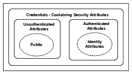

A Credentials object (as shown in Figure 12-2) holds the security attributes of a principal. The Credentials object provides methods to obtain and set the security attributes of the principals it represents. These security attributes include its authenticated or unauthenticated identities and privileges. It also contains information for establishing security associations.
Credentials objects are created as the result of:
Multiple references to a Credentials object are supported. A Credentials object is stateful. It maintains state on behalf of the principal for which it was created. This state includes any information necessary to determine the identity and privileges of the principal it represents. Credentials objects are not associated with the Principal Authenticator object that created it, but must contain some indication of the authentication authority that certified the principal’s identity.
The Credentials object is a locality-constrained object; therefore, a Credentials object may not be used through the DII/DSI facilities. Any attempt to pass a reference to this object outside of the current process, or any attempt to externalize it using CORBA::ORB::object_to_string, will result in the raising of the CORBA::MARSHAL exception.
The Credentials object has been enhanced to allow application developers to indicate the security attributes for establishing secure connections. These attributes allow developers to indicate whether a secure connection requires integrity, confidentiality, or both. To support this capability, two new attributes were added to the SecurityLevel2::Credentials interface.
invocation_options_supported attribute indicates which security options are allowed when establishing a secure connection. invocation_options_required attribute allows the application developer to specify the minimum set of security options that must be used in establishing a secure connection.

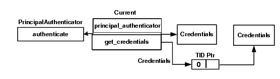

The SecurityCurrent object (see Figure 12-3) represents the current execution context at both the principal and target objects. The SecurityCurrent object represents service-specific state information associated with the current execution context. Both client and server applications have SecurityCurrent objects that represent the state associated with the thread of execution and the process in which the thread is executing.
The SecurityCurrent object is a singleton object; there is only a single instance allowed in a process address space. Multiple references to the SecurityCurrent object are supported.
The CORBAservices Security Service specification defines two interfaces for the SecurityCurrent object associated with security:
Both interfaces give access to security information associated with the execution context.
At any stage, a client application can determine the default credentials for subsequent invocations by calling the Current::get_credentials method and asking for the invocation credentials. These default credentials are used in all invocations that use object references.
When the Current::get_attributes method is invoked by a client application, the attributes returned from the Credentials object are those of the principal.
The SecurityCurrent object is a locality-constrained object; therefore, a SecurityCurrent object may not be used through the DII/DSI facilities. Any attempt to pass a reference to this object outside of the current process, or any attempt to externalize it using CORBA::ORB::object_to_string, results in a CORBA::MARSHAL exception.
