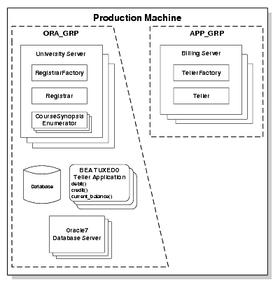

Figure 2-1 shows the replicated ORA_GRP and APP_GRP groups running on a single machine.
When a request arrives for either of these groups, the Oracle Tuxedo domain has several server processes available that can process the request, and the Oracle Tuxedo domain can choose the server process that is the least busy.
In Figure 2-1, note the following points:

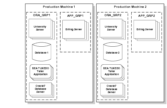

This section describes how the Production sample application replicates server groups. For an introduction to this feature, see Replicating Server Groups.
Figure 2-2 shows the Production sample application groups replicated on another machine, as specified in the application’s UBBCONFIG file, as ORA_GRP2 and APP_GRP2.
In Figure 2-2, the only difference between the content of the groups on Production Machines 1 and 2 is the database:
| Note: | The course information table in both databases is identical. |
Note that the student information in a given database may be completely unrelated to the account information in the same database.
For more information about how the Production sample application uses factory-based routing to distribute the application’s processing load across multiple machines, see Scaling with Factory-based Routing.
