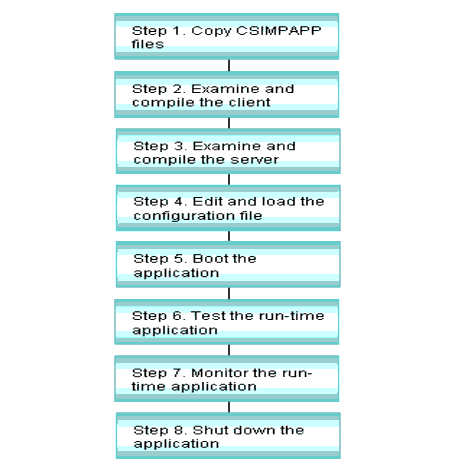

This topic leads you through the procedures you must complete to develop CSIMPAPP. The following flow chart summarizes this procedure.
Click on each task for instructions on completing that task.
