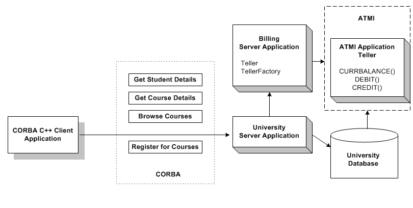

In the Wrapper sample application, when a student registers for classes, the student’s account is charged for the classes and the balance of the student’s account is updated. In addition, students can get information about their account balances.
The Wrapper sample application incorporates a ATMI service. The Billing server application contains a Teller object, which calls the ATMI application Teller. The Teller application performs the following billing operations:
The University database is modified to include account information.
Figure 6-1 illustrates how the Wrapper sample application works.
