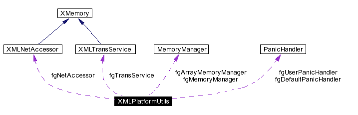

Collaboration diagram for XMLPlatformUtils:  [legend]List of all members.

 Static Public Attributes |  |  |  | XMLNetAccessor * | fgNetAccessor |  |  | The network accessor. More...
 |  | XMLTransService * | fgTransService |  |  | The transcoding service. More...
 |  | PanicHandler * | fgUserPanicHandler |  |  | The Panic Handler. More...
 |  | PanicHandler * | fgDefaultPanicHandler |  |  | The Panic Handler. More...
 |  | MemoryManager * | fgMemoryManager |  |  | The configurable memory manager. More...
 |  | MemoryManager * | fgArrayMemoryManager |  |  | The array-allocating memory manager. More...
 |  | XMLMutex * | fgAtomicMutex |
