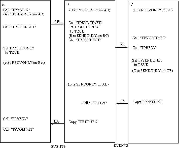

Figure 14-1 shows a conversational connection hierarchy that includes a global transaction. The originator of a connection in transaction mode (process A that called TPBEGIN followed by TPCONNECT) can call TPCOMMIT after all services have called TPRETURN. If a hierarchy of connections exists as it does in Figure 14-1, each subordinate service must call TPRETURN when it no longer has replies outstanding. A TPEV-SVCSUCC or TPEV-SVCFAIL event setting for TPEVENT IN TPSTATUS-REC is sent back up the hierarchy to the process that began the transaction. If all subordinates return successfully, the client (Process A) completes the transaction; otherwise the transaction is aborted.
Figure 14-1 Connection Hierarchy: Transaction Mode
