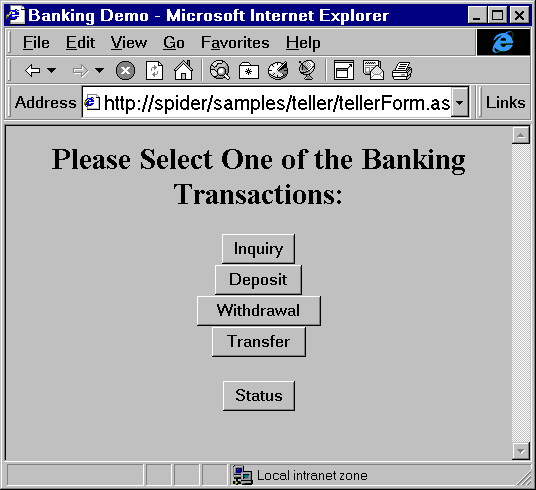

To start the walkthrough, use the browser on your client to connect to the Web server where the Jolt Asp Connectivity for BEA Tuxedo classes are installed. The first page to download is tellerForm.asp (see the following figure for an example of a tellerForm.asp page). If the teller sample has been installed as described in the Getting Started Checklist, the URL for this page will be:
http://<web-server:port>/teller/tellerForm.asp
Note: The use of the port number is optional, depending on how your Web server is configured. In most cases, you are not required to add the ":port" in the URL.
tellerForm.asp Example
The page, tellerForm.asp, contains VBScript procedures required to initialize the Jolt Session Pool Manager. The initialization code is contained in an ASP Script block. This code tells the Web server to execute this block of code on the server, instead of sending it to the client. tellerForm.asp: Initialize the Jolt Session Pool Manager The VBScript procedure web_initSessionMgr() calls other VBScript procedures to establish a pool of Jolt sessions. A Jolt session is established between the Jolt ASP Connectivity for BEA Tuxedo in the Web server and the Jolt Servers that reside in your BEA Tuxedo application. One of the procedures called is web_start(). This procedure (in the file web_start.inc) should have been edited as part of the teller application installation process in the Getting Started Checklist. The procedure web_cacheTemplates() reads various HTML template files into a memory cache. This step is not required, but it improves performance. tellerForm.asp: Allow the User to Choose TRANSFER Service The HTML segment shown in the previous listing displays a button labeled "Transfer." When this button is selected, the browser loads the page transferForm.htm. This page presents a form used to enter the data required by the TRANSFER service. Submitting a TRANSFER Request from the Client The form in the following figure "transferForm.htm Example" is generated by the page transferForm.htm. This page presents you with a form for input. The page consists of three text fields (two account numbers and a dollar amount), and a button that, when pressed, causes the TRANSFER service to be invoked. transferForm.htm Example
'// Initialize the session manager and cache templates
Call web_initSessionMgr(Null)
Call web_cacheTemplates()
%><INPUT TYPE="button" VALUE="Transfer"
onClick="window.location='transferForm.htm'">

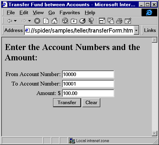

The code segment in the following listing shows the key HTML elements for this page. The bolded text in the following listing correspond to the elements in the table Key HTML Elements and Descriptions. transferForm.htm: TRANSFER Form
<FORM NAME="teller" ACTION="tlr.asp" METHOD="POST">
<TABLE>
<TR><TD ALIGN=RIGHT>From Account Number: </TD>
<TD><INPUT TYPE="text" NAME="ACCOUNT_ID_0"></TD></TR>
<TR><TD ALIGN=RIGHT>To Account Number: </TD>
<TD><INPUT TYPE="text" NAME="ACCOUNT_ID_1"></TD></TR>
<TR><TD ALIGN=RIGHT>Amount: $</TD>
<TD><INPUT TYPE="text" NAME="SAMOUNT"></TD></TR>
</TABLE>
<CENTER>
<INPUT TYPE="hidden" NAME="SVCNAME" VALUE="TRANSFER">
<INPUT TYPE="submit" VALUE="Transfer">
<INPUT TYPE="reset" VALUE="Clear">
</CENTER>
</FORM>
The HTML form field names used in this example exactly match the BEA Tuxedo field names expected by the TRANSFER service. This is not required, but doing so facilitates processing on the server because you do not have to map these inputs to BEA Tuxedo field names. This is done by the Jolt ASP Connectivity for BEA Tuxedo classes.
The hidden field SVCNAME is assigned a value of TRANSFER. This field does not appear on the client form, but it is sent to the Web server as part of the request. The VBScript program retrieves the value of this field in order to determine which BEA Tuxedo service is to be called (in this example, the service is TRANSFER).
Complete the fields From Account Number, To Account Number, and Amount. (10000 and 10001 are valid BankApp account numbers). Click the Transfer button. The data entered on the form is sent to the Web server for processing by the program tlr.asp as specified in the ACTION field of the form.

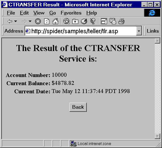

Returning the Results to the Client
At this stage, no results have been returned to the client. The final step sends an HTML page containing the results of the service call back to the client. The HTML page consists of the template merged with the data returned by the service call shown in the previous listing "tlr.asp: Invoke the BEA Tuxedo Service".
The template file contains placeholders for variable (call-specific) data. These placeholders are identified by the special tag <%=NAME%>. In the code example shown in the following listing, an index is used to indicate which occurrence of a parameter name is used. For example, ACCOUNT_ID[0] specifies the first occurrence of the field ACCOUNT_ID.
transfer.temp: Placeholders for TRANSFER Results
<TABLE BORDER=1>
<TR><TD></TD><TD ALIGN=CENTER><B>Account #</B></TD>
<TD ALIGN=CENTER><B>Balance</B></TR>
<TR><TD ALIGN=RIGHT><B>From:</B></TD><TD><%=ACCOUNT_ID[0]%></TD>
<TD><%=SBALANCE[0]%></TR>
<TR><TD ALIGN=RIGHT><B>To:</B></TD><TD><%=ACCOUNT_ID[1]%></TD>
<TD><%=SBALANCE[1]%></TR>
</TABLE>
To substitute the placeholders in the template with the actual values of the data returned from the service call, use the eval() method of the Template object shown in the following listing. This method matches placeholders in the template file with fields of the same name in the results data and replaces them accordingly. A check for valid results (output object) is done as shown in the following listing. If there is no output object, an error template page is returned.
tlr.asp: Template Processing
path = Application("templatedir")
If (Not IsObject(output)) Or (output is Nothing) Then
Call template.evalFile(path & "\nosession.temp", Null)
Elseif output.noError() Then
Call template.eval(iodata)
Elseif output.applicationError() Then
Call template.evalFile(path & "\error.temp", iodata)
Else
'// System error
Dim errdata(0)
Set errdata(0) = Server.CreateObject("BEAWEB.TemplateData")
Call errdata(0).setValue("ERRNO", output.getError())
Call errdata(0).setValue("ERRMSG", output.getStringError())
Call template.evalFile(path & "\syserror.temp", errdata)
End If
Note: The array iodata contains both the input request and the results from the service call. This is useful if you want the results page to contain data that is part of the input.
When the template is processed, the resulting HTML is returned to the client as shown in the following figure.
