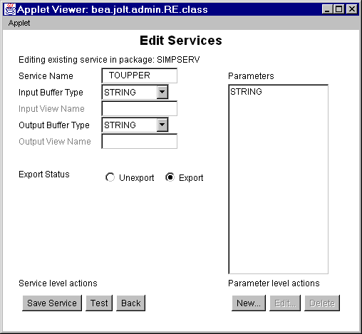

Define TOUPPER in the Repository Editor
Before running the ToUpper.java example, you need to define the TOUPPER service through the Jolt Repository Editor.
Note: Refer to Using the Jolt Repository Editor for more information about defining your services and adding new parameters.
Add a TOUPPER Service
Set Input and Output Buffer Types to STRING

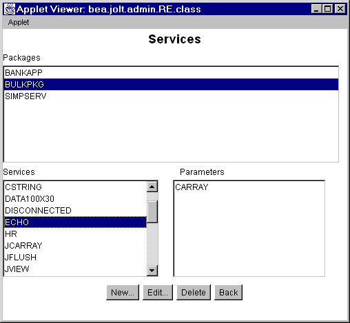

Define the Tuxedo Service in the Repository Editor
Before running the ECHO example, you must write and boot a Tuxedo ECHO service. The ECHO service takes a buffer and passes it back to the Jolt client. You need to define the ECHO service in the Jolt Repository Editor.
Repository Editor: Add the ECHO Service
Use the Repository Editor to add the ECHO service as follows:
Note: If using the X_OCTET buffer type, you must change the Input Buffer Type and Output Buffer Type fields to X_OCTET.
Repository Editor: Edit ECHO Service

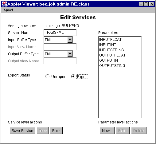

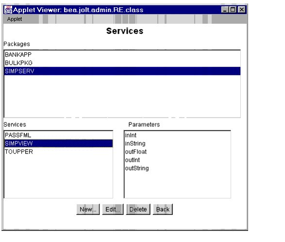

Define PASSFML in the Repository Editor
The BULKPKG package contains the PASSFML service, which is used with the tryOnFml.java and tryOnFml.c code. Before running the tryOnFml.java example, you need to modify the PASSFML service through the Jolt Repository Editor.
Note: Refer to Using the Jolt Repository Editor for more information about defining a service.
The figure Repository Editor Window: Edit Services (PASSFML) illustrates the PASSFML service, and Input Buffer and Output Buffer of FML.

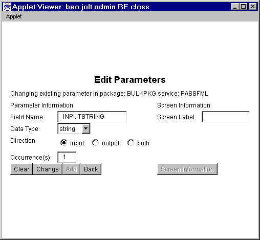

Edit the PASSFML Parameters

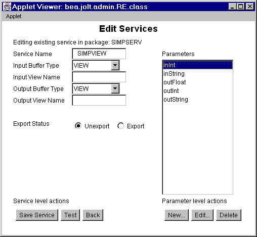

Define VIEW in the Repository Editor
Before running the simpview.java and simpview.c examples, you need to define the SIMPVIEW service through the Jolt Repository Editor.
Repository Editor: Add SIMPVIEW Service
In the Repository Editor add the VIEW service as follows:
Repository Editor: Edit SIMPVIEW Service
Note: If using the X_COMMON or X_C_TYPE buffer types, you must put the correct buffer type in the Input Buffer Type and Output Buffer Type fields. Additionally, you must choose the corresponding Input View Name and Output View Name fields.

VIEW Field Definitions
The "simpview.v16 Field Definitions" listing shows the BEA Tuxedo VIEW field definitions for the simpview.java example that were shown in the previous listing.

To use the XML buffer type, you first define the Tuxedo service that you will be using with the buffer type, and then write the code that uses the buffer type. The next two sections demonstrate these steps.
Note: Similar to CARRAY, the XML buffer type is treated as a byte arrary, not a STRING. Therefore, no data conversion takes place between a Jolt client and a BEA Tuxedo service.

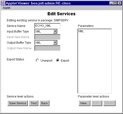

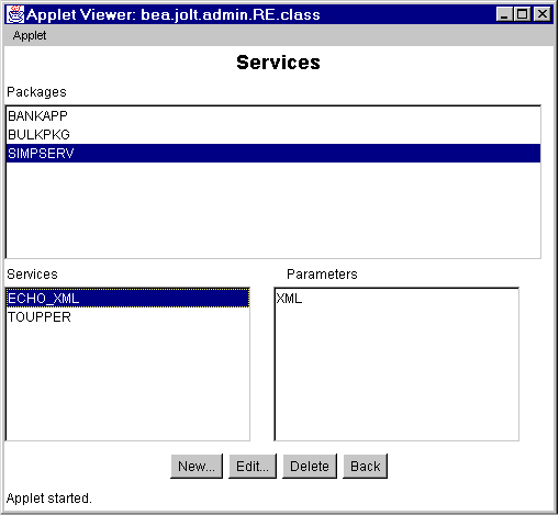

Before running the XML example, you must write and boot a Tuxedo XML service. The XML service takes a buffer and passes it back to the Jolt client. You need to define the XML service in the Jolt Repository Editor.
Repository Editor: Add the XML Service
Use the Repository Editor to add the XML service as follows:
Repository Editor: Edit the XML Service
