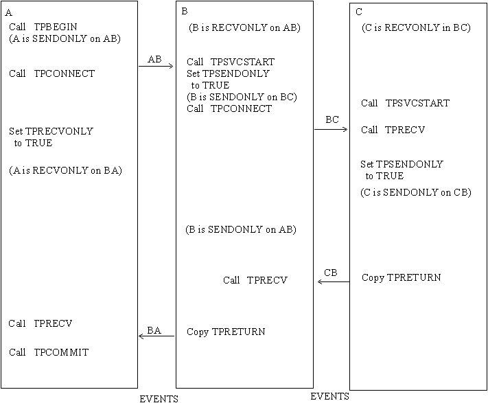

Example: Committing a Transaction in Conversational Mode
The following figure illustrates a conversational connection hierarchy that includes a global transaction.
Connection Hierarchy in Transaction Mode
  The connection hierarchy is created through the following process:
