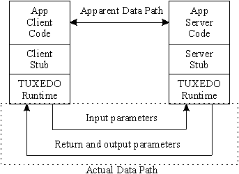

Figure 1-1 illustrates how an RPC is made to look like a local procedure call.
The client application code calls one of the operations (functions) defined in the IDL file. Instead of calling the actual function, which resides on the server side, the client stub is called. The client stub is generated by the IDL compiler based on the IDL input file, which defines the data types and operations. For each operation, the input parameters, return type, and output parameters are defined. The client stub takes the input parameters and converts them into a single buffer of data, sends the data to the server and waits for a response, and unpacks the buffer of data sent back from the server (the return value and output parameters). The communication between the client and server processes, whether intra-machine or inter-machine is handled by the BEA TUXEDO system runtime.
On the server side, the runtime calls the server stub for the interface, also generated by the IDL compiler. This stub unpacks the data buffer that contains the input parameters, in some cases it allocates space needed for output parameters of the operation, calls the operation and waits for it to return, packs the return value and output parameters into a buffer and sends the response back to the client.
From the application perspective, it appears that a simple local procedure call is done. The stubs and the runtime hide the calling of a remote procedure in a non-local address space (process).

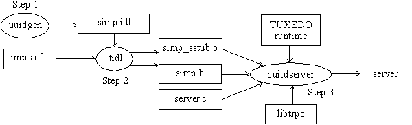

When the application code is completed, it's time to compile and link it together with the BEA TUXEDO system runtime. Two programs are provided to simplify this process: The complete process for building a server and client are shown in the following two figures. More details about building client and server programs on different platforms are given in Chapter 4, "Building RPC Client and Server Programs."
In Figure 1-2, the process for building a server is illustrated.

Figure 1-1 RPC Communication

buildserver for the server, and buildclient for the client. These programs compile any source files and link the object and library files with the BEA TUXEDO runtime to produce the executable files. These programs allow for alternate compilers and compilation options to be specified. See the buildserver(1) and buildclient(1) reference pages for further details.
Figure 1-2 Building an RPC Server
uuidgen to generate a skeleton IDL file (simp.idl) with a UUID. Edit the
template IDL file to define the interface between the client and server using the
interface definition language.

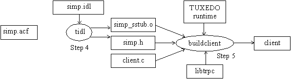

The process for building a client is illustrated in Figure 1-3.
Figure 1-3 Building an RPC Client
tidl) to generate the
interface header file and the client stub object file.
