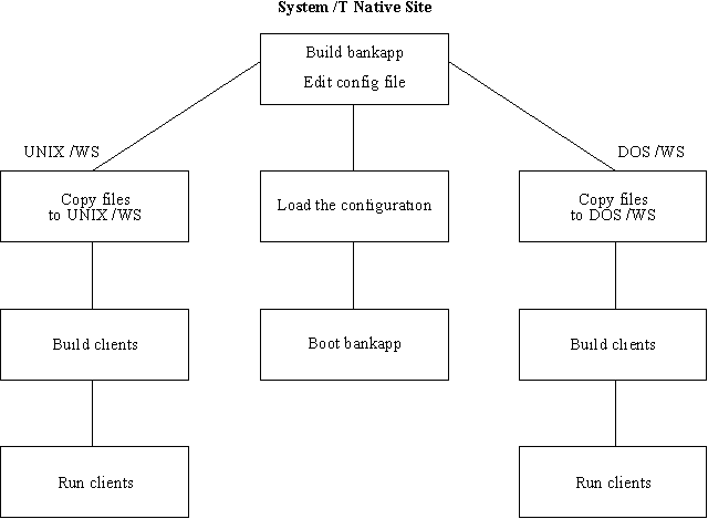

Figure 9-1 shows the steps in the process of bringing up
Install and build the You need to edit the configuration file you plan to use (either Also, remember to increase the At some point, before you can start using /WS clients, you need to run This section covers the installation of The source files shown in Listing 9-1 are the The Process Diagrammed
bankapp
on workstations, and also provides an outline of the subjects in this chapter.
Figure 9-1 Steps in bringing up bankapp
