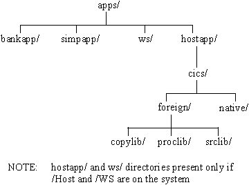

This chapter describes the directory structure under the
Table 2-1 lists the files of the banking application. The left hand column lists the source files delivered with the BEA TUXEDO software. The center column lists files that are generated when the Directory Structure for bankapp
apps directory, which is subordinate to the root directory for your BEA TUXEDO system software. We will also take a look at the files in the bankapp directory. The directory structure is shown in Figure 2-1.
Figure 2-1 Directory Structure under apps/
simpapp is described in Chapter 1, "A Simple Application." hostapp is not distributed except under special arrangements.
